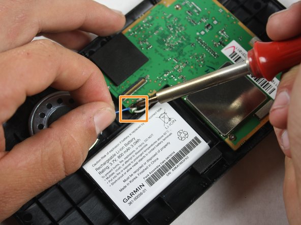

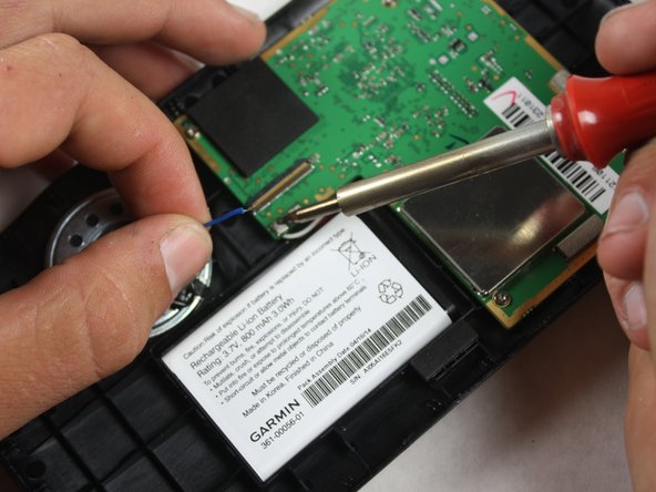

    • This step requires soldering. If you are new to soldering, reference the Soldering Section of Ifixit's Device Skills Page for helpful information on soldering.
    • Disconnect the speaker wires by desoldering them from the terminals on the motherboard.
    • Plug in the soldering station and give it at least 5 minutes to heat up.
    • The soldering iron and molten solder are very hot and can burn you!
    • Touch the tip of the soldering iron to each terminal until the solder begins to melt.
    • Once the solder melts, gently pull the wire away from its connection to the terminal with your hands.

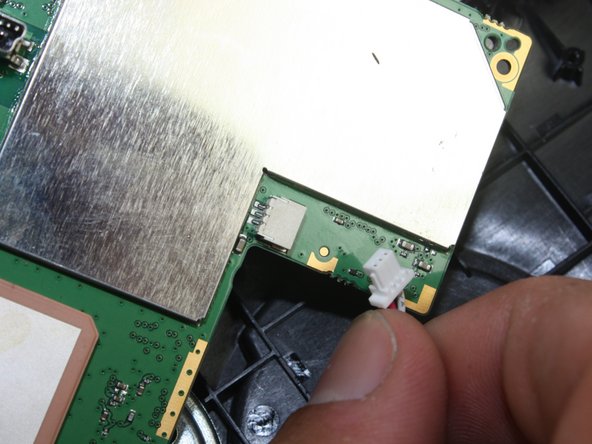

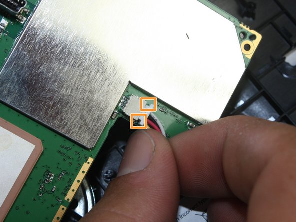

  8. Garmin Nuvi 65LM Motherboard Replacement: crwdns2935265:08crwdnd2935265:01crwdnd2935265:03crwdne2935265:0 Garmin Nuvi 65LM Motherboard Replacement: crwdns2935265:08crwdnd2935265:02crwdnd2935265:03crwdne2935265:0 Garmin Nuvi 65LM Motherboard Replacement: crwdns2935265:08crwdnd2935265:03crwdnd2935265:03crwdne2935265:0
    • Turn the motherboard over to find the power connection.
    • Gently un-connect the plug by using your thumbnail (or prying device) to catch on its grooves, then pulling away from the connection.
