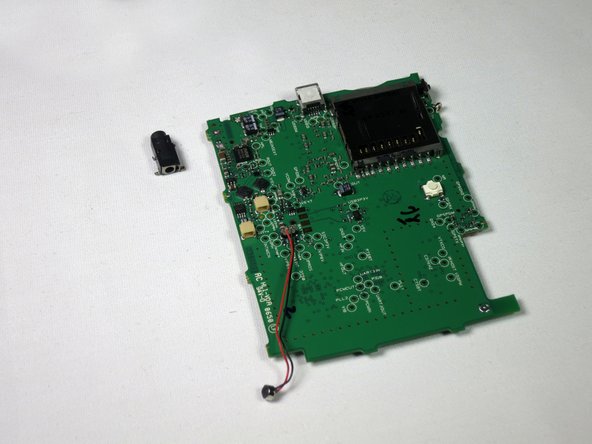

  5. Garmin Nuvi 370 Auxiliary Audio Out Port Replacement: crwdns2935265:05crwdnd2935265:01crwdnd2935265:02crwdne2935265:0 Garmin Nuvi 370 Auxiliary Audio Out Port Replacement: crwdns2935265:05crwdnd2935265:02crwdnd2935265:02crwdne2935265:0
    Desoldering Pump
    $3.99
    • De-solder the audio out port. Use a soldering iron to melt the solder on each of the leads of the port and a solder extraction tool (not shown), such as a solder sucker or copper braid.
    • Use tweezers to grab the port for greater protection and precision.
  6. Garmin Nuvi 370 Auxiliary Audio Out Port Replacement: crwdns2935265:06crwdnd2935265:01crwdnd2935265:01crwdne2935265:0
    • The audio out port should now be completely separated from all other components.
    • Solder new, functional audio port. Make sure all solder connections are clean.
