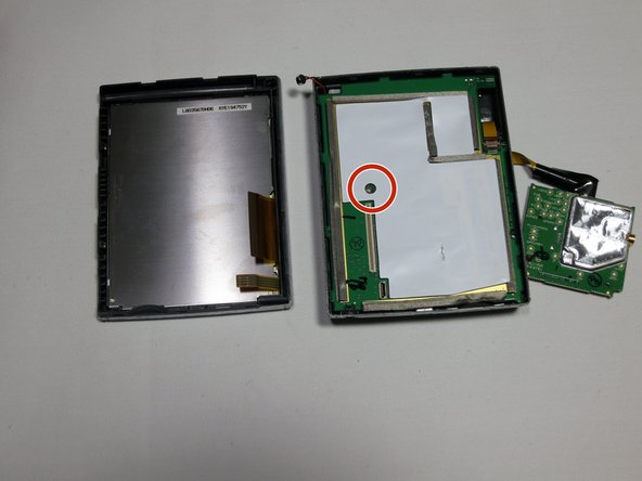

  5. Disassembling Garmin Nuvi 370 Into Core Components: crwdns2935265:05crwdnd2935265:01crwdnd2935265:03crwdne2935265:0 Disassembling Garmin Nuvi 370 Into Core Components: crwdns2935265:05crwdnd2935265:02crwdnd2935265:03crwdne2935265:0 Disassembling Garmin Nuvi 370 Into Core Components: crwdns2935265:05crwdnd2935265:03crwdnd2935265:03crwdne2935265:0
    • Detach the front display from the back panel of the device.
  6. Disassembling Garmin Nuvi 370 Into Core Components: crwdns2935265:06crwdnd2935265:01crwdnd2935265:02crwdne2935265:0 Disassembling Garmin Nuvi 370 Into Core Components: crwdns2935265:06crwdnd2935265:02crwdnd2935265:02crwdne2935265:0
    • Using tweezers, gently lift the microphone from its resting position to fully separate the device into two parts.
    • Finally, remove the screw that connects the motherboard to the back casing with a 3mm head driver.
