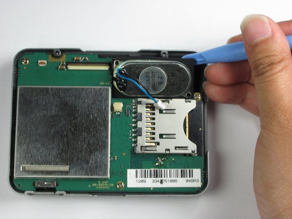

  4. Garmin Nuvi 200 Speaker Replacement, Speaker: crwdns2935265:04crwdnd2935265:01crwdnd2935265:01crwdne2935265:0
    • Unscrew the two screws on opposite sides of the speaker using the #00 Phillips screwdriver.
  5. Garmin Nuvi 200 Speaker Replacement: crwdns2935265:05crwdnd2935265:01crwdnd2935265:01crwdne2935265:0
    • Pull the cable out to detach the speaker from the logic board.
  6. Garmin Nuvi 200 Speaker Replacement: crwdns2935265:06crwdnd2935265:01crwdnd2935265:03crwdne2935265:0 Garmin Nuvi 200 Speaker Replacement: crwdns2935265:06crwdnd2935265:02crwdnd2935265:03crwdne2935265:0 Garmin Nuvi 200 Speaker Replacement: crwdns2935265:06crwdnd2935265:03crwdnd2935265:03crwdne2935265:0
    • Wedge the iPod opener into the space between the speaker and the case.
    • Apply pressure to pry the speaker away from the case.

just a note i had a problem with the speaker in my nuvi 200 an upon opening up found speaker plug had come loose i guess from being dropped a few times pushed plug in an works fine please check all connections before replacing your speaker saved me $$ thanks for a great site everyone...
