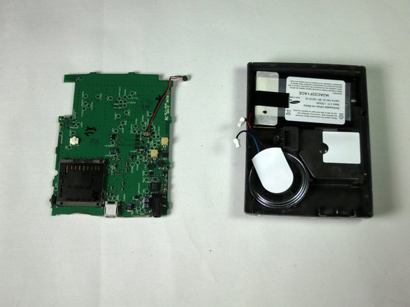

    • Use the tweezers or the spudger to lift the tan latch off the ribbon cable (ZIF connector)and gently pull out the ZIF connector and cable from underneath the opened latch.
  3. Garmin Nüvi 370 Battery Replacement: crwdns2935265:03crwdnd2935265:01crwdnd2935265:02crwdne2935265:0 Garmin Nüvi 370 Battery Replacement: crwdns2935265:03crwdnd2935265:02crwdnd2935265:02crwdne2935265:0
    • The motherboard will now freely separate from the back casing; lay it flat next to the housing.
  4. Garmin Nüvi 370 Battery Replacement: crwdns2935265:04crwdnd2935265:01crwdnd2935265:02crwdne2935265:0 Garmin Nüvi 370 Battery Replacement: crwdns2935265:04crwdnd2935265:02crwdnd2935265:02crwdne2935265:0
    • Disconnect the speaker and battery from their terminals on the motherboard. This should disconnect the motherboard completely from the back panel.
    • It is recommended that you use tweezers or the spudger for precision.

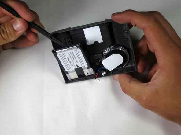

  5. Garmin Nüvi 370 Battery Replacement: crwdns2935265:05crwdnd2935265:01crwdnd2935265:02crwdne2935265:0 Garmin Nüvi 370 Battery Replacement: crwdns2935265:05crwdnd2935265:02crwdnd2935265:02crwdne2935265:0
    • Using the flat edge of the spudger from above, gently pry the battery away from the plastic.
  6. Garmin Nüvi 370 Battery Replacement: crwdns2935265:06crwdnd2935265:01crwdnd2935265:01crwdne2935265:0
    • The battery should now be completely separated from the other components.
    • Insert new, functional battery.
