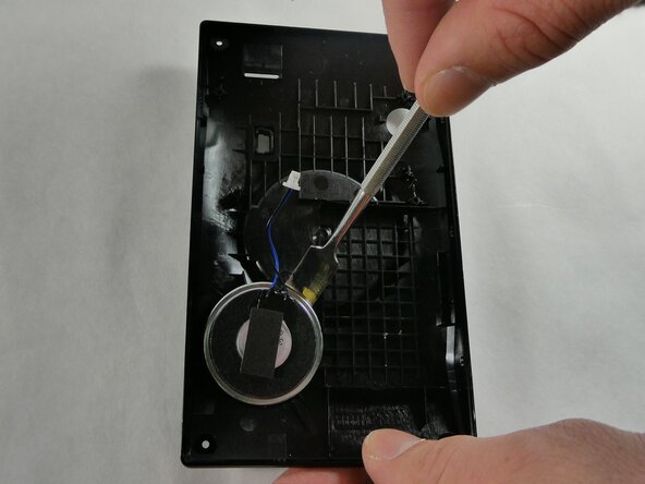

    • Pop the suction cup off of the device.
    • Unscrew the four T5 Torx screws on the back.
    • Carefully pry apart the front and back with a Jimmy.
  2. Garmin Drive 52 and Traffic Speaker Replacement: crwdns2935265:02crwdnd2935265:01crwdnd2935265:01crwdne2935265:0
    • With the top in hand, carefully apply pressure on the top of the screen to pop it out of the front of the case.
  3. Garmin Drive 52 and Traffic Speaker Replacement: crwdns2935265:03crwdnd2935265:01crwdnd2935265:02crwdne2935265:0 Garmin Drive 52 and Traffic Speaker Replacement: crwdns2935265:03crwdnd2935265:02crwdnd2935265:02crwdne2935265:0
    • Remove the four Torx T5 screws.
    • Unplug the two connectors from the motherboard and lift it up and out.
  4. Garmin Drive 52 and Traffic Speaker Replacement, Speaker: crwdns2935265:04crwdnd2935265:01crwdnd2935265:01crwdne2935265:0
    • Gently lift the speaker out.
    • Do not use a metal spudger or tool to pry the speaker or any components. Using incorrect tools could damage your device.
To reassemble your device, follow these instructions in reverse order. Take your e-waste to an R2 or e-Stewards certified recycler.
