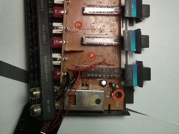

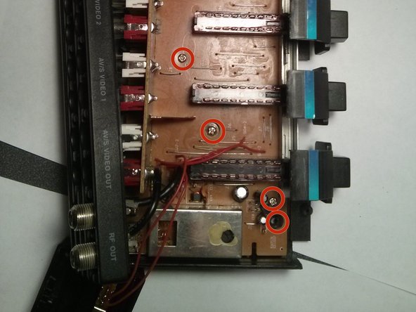

  6. GameStop Universal System Selector MotherBoard Replacement: crwdns2935265:06crwdnd2935265:01crwdnd2935265:02crwdne2935265:0 GameStop Universal System Selector MotherBoard Replacement: crwdns2935265:06crwdnd2935265:02crwdnd2935265:02crwdne2935265:0
    • Remove all six screws from the circuit board with a Phillips #00 screwdriver.
    • These screws look similar to others already removed, therefor ensure they are placed in a secured area.

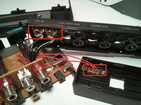

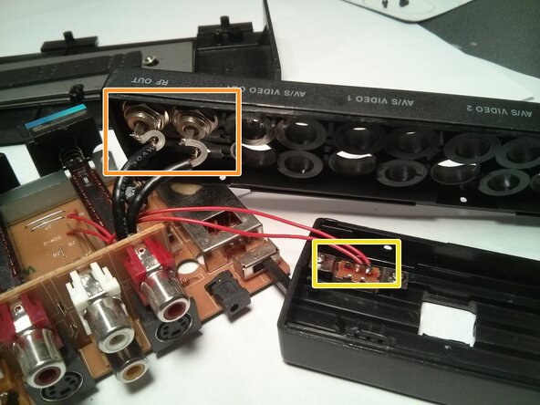

  7. GameStop Universal System Selector MotherBoard Replacement: crwdns2935265:07crwdnd2935265:01crwdnd2935265:02crwdne2935265:0 GameStop Universal System Selector MotherBoard Replacement: crwdns2935265:07crwdnd2935265:02crwdnd2935265:02crwdne2935265:0
    • Now the circuit board should be able to be removed from the casing of the device except for two wires that are attached to the casing.
    • Detach the black wires from the casing, by carefully pulling them out of the cable ports.
    • Using pliers or a similar tool, detach the red wires from the small circuit board that is attached to the case of the device.
  8. GameStop Universal System Selector MotherBoard Replacement: crwdns2935265:08crwdnd2935265:01crwdnd2935265:02crwdne2935265:0 GameStop Universal System Selector MotherBoard Replacement: crwdns2935265:08crwdnd2935265:02crwdnd2935265:02crwdne2935265:0
    • Now it's time to replace the old circuit board with the new one.
    • Push the two black wire's ends into the cable ports on the back panel of the casing.
    • Solder the ends of the two red wires onto the small circuit board on the front panel of the device.
  9. GameStop Universal System Selector MotherBoard Replacement: crwdns2935265:09crwdnd2935265:01crwdnd2935265:02crwdne2935265:0 GameStop Universal System Selector MotherBoard Replacement: crwdns2935265:09crwdnd2935265:02crwdnd2935265:02crwdne2935265:0
