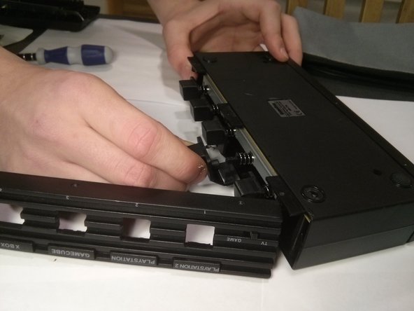

    • Disconnect the DC 6V IN power cable from the device.
    • Remove the three front panel screws on the bottom of the device using the Phillips #00 Screwdriver.
  2. GameStop Universal System Selector Button Replacement: crwdns2935265:02crwdnd2935265:01crwdnd2935265:01crwdne2935265:0
    • Carefully pry off the front panel of the device to reveal the button in need of replacement.
    • The outer piece of the device is plastic and may break it not carefully handled.
  3. GameStop Universal System Selector Button Replacement: crwdns2935265:03crwdnd2935265:01crwdnd2935265:02crwdne2935265:0 GameStop Universal System Selector Button Replacement: crwdns2935265:03crwdnd2935265:02crwdnd2935265:02crwdne2935265:0
    • Pull firmly on the button in need of replacement to free it from its housing.
  4. GameStop Universal System Selector Button Replacement: crwdns2935265:04crwdnd2935265:01crwdnd2935265:01crwdne2935265:0
    • Gently push the replacement button into the housing.
  5. GameStop Universal System Selector Button Replacement: crwdns2935265:05crwdnd2935265:01crwdnd2935265:01crwdne2935265:0
    • Snap the front panel back into place.
    • Replace the 3 front panel screws.
The system selector button should now be working properly. Take your e-waste to an R2 or e-Stewards certified recycler.
