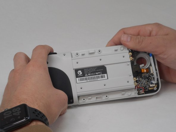

    • Turn the device so the back faces you.
  2. GameSir X2 Type-C Right Joystick Replacement: crwdns2935265:02crwdnd2935265:01crwdnd2935265:02crwdne2935265:0 GameSir X2 Type-C Right Joystick Replacement: crwdns2935265:02crwdnd2935265:02crwdnd2935265:02crwdne2935265:0
    • Remove the eight 6 mm T6 Torx screws.
  3. GameSir X2 Type-C Right Joystick Replacement: crwdns2935265:03crwdnd2935265:01crwdnd2935265:01crwdne2935265:0
    • Use a straight edge to remove the rubber pad on the front of the device.
  4. GameSir X2 Type-C Right Joystick Replacement: crwdns2935265:04crwdnd2935265:01crwdnd2935265:02crwdne2935265:0 GameSir X2 Type-C Right Joystick Replacement: crwdns2935265:04crwdnd2935265:02crwdnd2935265:02crwdne2935265:0
    • Remove the four 4.5 mm screws with a Phillips #000 screwdriver.
  5. GameSir X2 Type-C Right Joystick Replacement: crwdns2935265:05crwdnd2935265:01crwdnd2935265:02crwdne2935265:0 GameSir X2 Type-C Right Joystick Replacement: crwdns2935265:05crwdnd2935265:02crwdnd2935265:02crwdne2935265:0
    • Use a straight edge to pry open the controller, following the seam on the controller.
    • Some force is necessary, but be careful not to damage any of the clips holding the controller together.

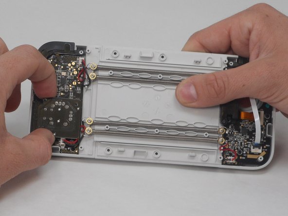

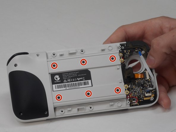

  6. GameSir X2 Type-C Right Joystick Replacement, Right Joystick: crwdns2935265:06crwdnd2935265:01crwdnd2935265:03crwdne2935265:0 GameSir X2 Type-C Right Joystick Replacement, Right Joystick: crwdns2935265:06crwdnd2935265:02crwdnd2935265:03crwdne2935265:0 GameSir X2 Type-C Right Joystick Replacement, Right Joystick: crwdns2935265:06crwdnd2935265:03crwdnd2935265:03crwdne2935265:0
    • Remove six 4.5 mm screws using the Phillips #000 screwdriver.

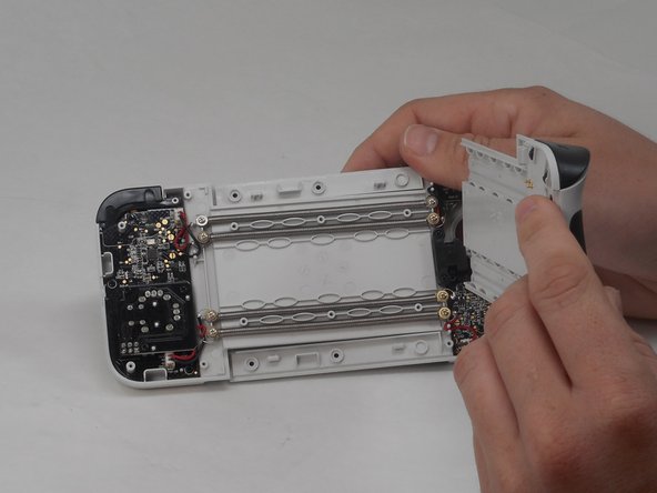

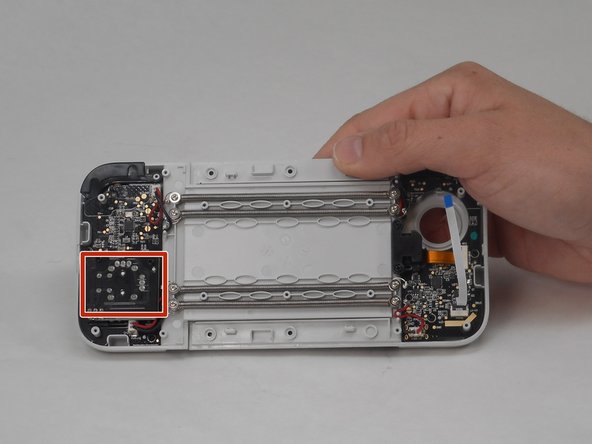

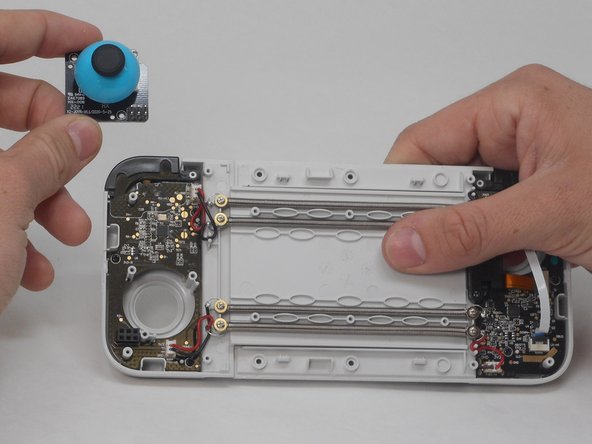

  7. GameSir X2 Type-C Right Joystick Replacement: crwdns2935265:07crwdnd2935265:01crwdnd2935265:02crwdne2935265:0 GameSir X2 Type-C Right Joystick Replacement: crwdns2935265:07crwdnd2935265:02crwdnd2935265:02crwdne2935265:0
    • Remove the left panel of the back cover to expose the joystick.
    • The joystick is attached to the black board.

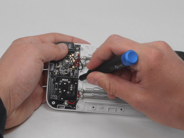

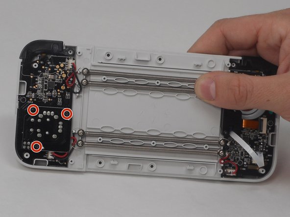

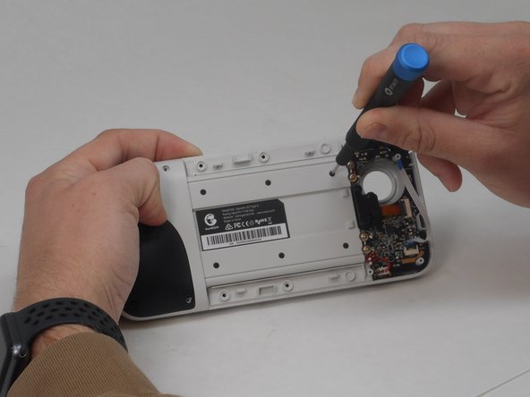

  8. GameSir X2 Type-C Right Joystick Replacement: crwdns2935265:08crwdnd2935265:01crwdnd2935265:02crwdne2935265:0 GameSir X2 Type-C Right Joystick Replacement: crwdns2935265:08crwdnd2935265:02crwdnd2935265:02crwdne2935265:0
    • Remove three 6 mm screws using a Phillips #00 screwdriver.
  9. GameSir X2 Type-C Right Joystick Replacement: crwdns2935265:09crwdnd2935265:01crwdnd2935265:02crwdne2935265:0 GameSir X2 Type-C Right Joystick Replacement: crwdns2935265:09crwdnd2935265:02crwdnd2935265:02crwdne2935265:0
    • Pull the joystick assembly out.
