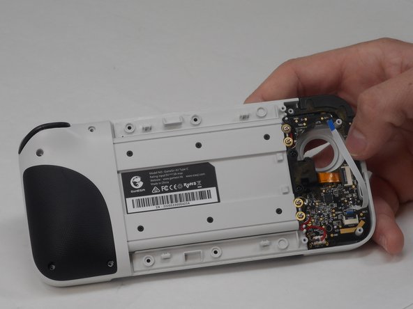

    • Turn the device so the back faces you.
  2. GameSir X2 Type-C Left Joystick Replacement: crwdns2935265:02crwdnd2935265:01crwdnd2935265:02crwdne2935265:0 GameSir X2 Type-C Left Joystick Replacement: crwdns2935265:02crwdnd2935265:02crwdnd2935265:02crwdne2935265:0
    • Remove the eight 6 mm T6 Torx screws.

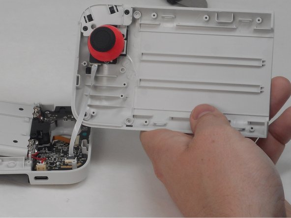

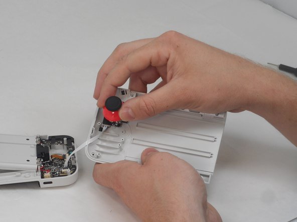

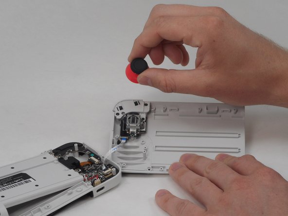

  6. GameSir X2 Type-C Left Joystick Replacement, Left Joystick: crwdns2935265:06crwdnd2935265:01crwdnd2935265:03crwdne2935265:0 GameSir X2 Type-C Left Joystick Replacement, Left Joystick: crwdns2935265:06crwdnd2935265:02crwdnd2935265:03crwdne2935265:0 GameSir X2 Type-C Left Joystick Replacement, Left Joystick: crwdns2935265:06crwdnd2935265:03crwdnd2935265:03crwdne2935265:0
    • Pull the joystick cap out of its socket.

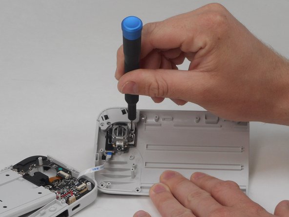

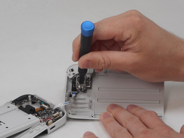

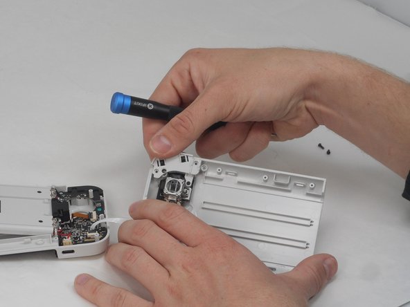

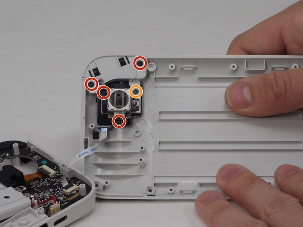

  7. GameSir X2 Type-C Left Joystick Replacement: crwdns2935265:07crwdnd2935265:01crwdnd2935265:03crwdne2935265:0 GameSir X2 Type-C Left Joystick Replacement: crwdns2935265:07crwdnd2935265:02crwdnd2935265:03crwdne2935265:0 GameSir X2 Type-C Left Joystick Replacement: crwdns2935265:07crwdnd2935265:03crwdnd2935265:03crwdne2935265:0
    • Remove the four 6 mm screws using a Phillips #00 screwdriver.
    • Remove the single 7.5 mm screw using a Phillips #00 screwdriver.

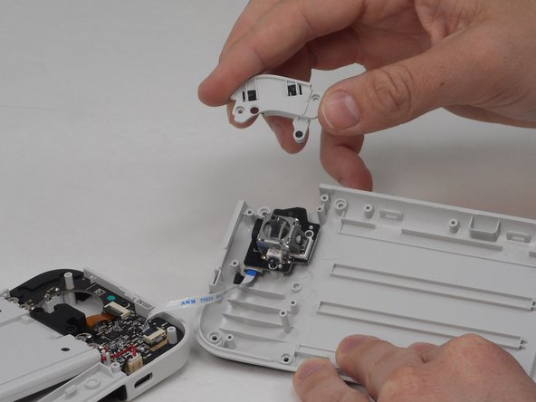

  8. GameSir X2 Type-C Left Joystick Replacement: crwdns2935265:08crwdnd2935265:01crwdnd2935265:02crwdne2935265:0 GameSir X2 Type-C Left Joystick Replacement: crwdns2935265:08crwdnd2935265:02crwdnd2935265:02crwdne2935265:0
    • Pull out the left trigger.

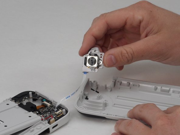

  9. GameSir X2 Type-C Left Joystick Replacement: crwdns2935265:09crwdnd2935265:01crwdnd2935265:01crwdne2935265:0
    • Pull out the left joystick.

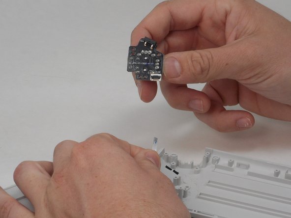

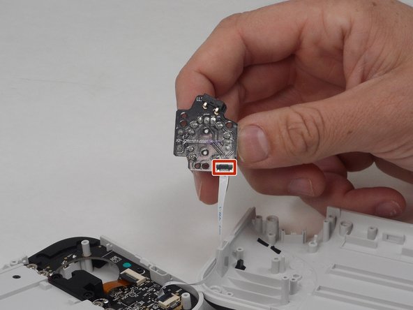

  10. GameSir X2 Type-C Left Joystick Replacement: crwdns2935265:010crwdnd2935265:01crwdnd2935265:03crwdne2935265:0 GameSir X2 Type-C Left Joystick Replacement: crwdns2935265:010crwdnd2935265:02crwdnd2935265:03crwdne2935265:0 GameSir X2 Type-C Left Joystick Replacement: crwdns2935265:010crwdnd2935265:03crwdnd2935265:03crwdne2935265:0
    • Flip up the black ZIF locking flap to disconnect the ribbon cable.
