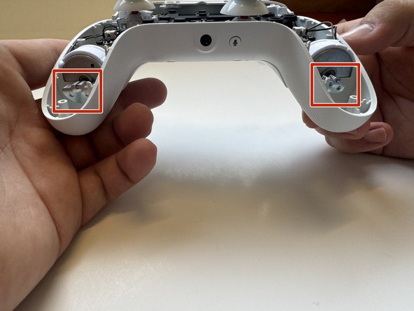

  4. GameSir G7 SE Rumble Motor Replacement, Rumble Motor: crwdns2935265:04crwdnd2935265:01crwdnd2935265:01crwdne2935265:0
    • Once you can see the internals of the controller, you need to remove the plug for the rumble motors. This plug is easy to remove and can be pulled straight out using your hands.
    • Use a pair of small pliers if you have difficulties.
  5. GameSir G7 SE Rumble Motor Replacement: crwdns2935265:05crwdnd2935265:01crwdnd2935265:02crwdne2935265:0 GameSir G7 SE Rumble Motor Replacement: crwdns2935265:05crwdnd2935265:02crwdnd2935265:02crwdne2935265:0
    • Once the plug is removed, you can easily pull out the rumble motor.
    • There is a left and right rumble motor, so be careful when replacing them. It is easy to differentiate them visually. Look for the size of the weights on the bottom; they will be different.
