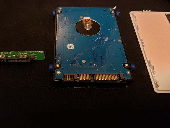

  1. Game Drive for Xbox Teardown, Open the Cover: crwdns2935265:01crwdnd2935265:01crwdnd2935265:01crwdne2935265:0
    • Using a Pry tool, remove the cover
    • This could break the plastic pins that keep the enclosure sealed. Nothing tape can't fix.
  2. Game Drive for Xbox Teardown, Remove the Cover: crwdns2935265:02crwdnd2935265:01crwdnd2935265:01crwdne2935265:0
    • Take the cover off the drive
    • Lifting from the end without the USB port. Remove the drive from the case.

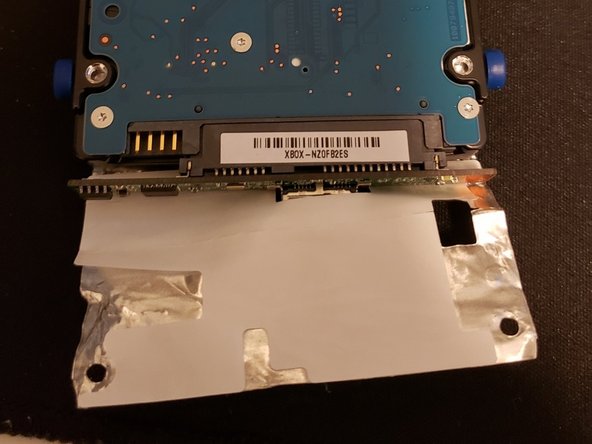

  3. Game Drive for Xbox Teardown, Remove the Shielding: crwdns2935265:03crwdnd2935265:01crwdnd2935265:02crwdne2935265:0 Game Drive for Xbox Teardown, Remove the Shielding: crwdns2935265:03crwdnd2935265:02crwdnd2935265:02crwdne2935265:0
    • Carefully peel away the shielding
  4. Game Drive for Xbox Teardown, Remove the USB Adapter: crwdns2935265:04crwdnd2935265:01crwdnd2935265:02crwdne2935265:0 Game Drive for Xbox Teardown, Remove the USB Adapter: crwdns2935265:04crwdnd2935265:02crwdnd2935265:02crwdne2935265:0
    • With careful pressure slowly pull the adapter off the drive.
    • Keep the adapter, it is Sata to USB 3.2 Gen 1, they have value
    • Don't pull from the end, you will likely break the adapter
