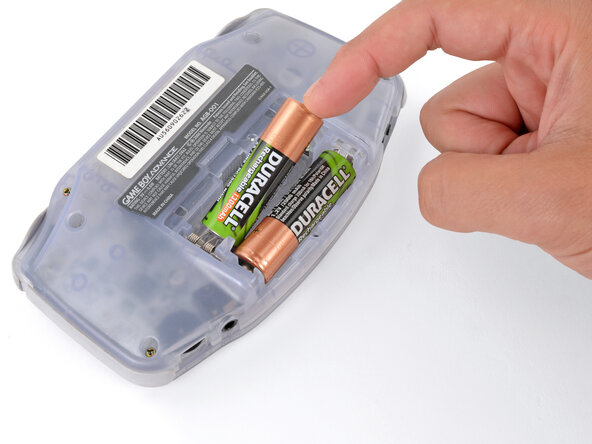

    2. Game Boy Advance LCD Screen Replacement, Remove the batteries: crwdns2935265:02crwdnd2935265:01crwdnd2935265:03crwdne2935265:0 Game Boy Advance LCD Screen Replacement, Remove the batteries: crwdns2935265:02crwdnd2935265:02crwdnd2935265:03crwdne2935265:0 Game Boy Advance LCD Screen Replacement, Remove the batteries: crwdns2935265:02crwdnd2935265:03crwdnd2935265:03crwdne2935265:0
      • Remove the two AA batteries.
      • If the metal terminals are corroded, follow this guide to clean them.
      • When installing batteries, use the diagram in the battery well to properly orient them.

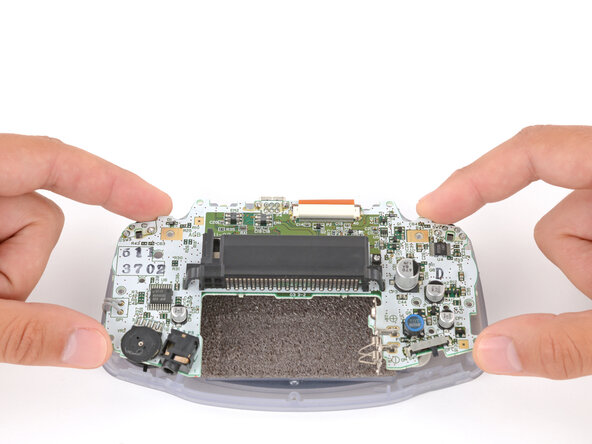

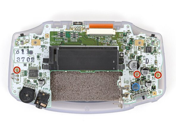

    1. Game Boy Advance LCD Screen Replacement, Buttons and LCD Screen: crwdns2935265:07crwdnd2935265:01crwdnd2935265:01crwdne2935265:0
      • Remove the three screws on the circuit board with a Phillips #1 screw driver.

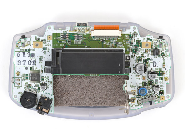

    2. Game Boy Advance LCD Screen Replacement: crwdns2935265:08crwdnd2935265:01crwdnd2935265:02crwdne2935265:0 Game Boy Advance LCD Screen Replacement: crwdns2935265:08crwdnd2935265:02crwdnd2935265:02crwdne2935265:0
      • Pull circuit board away from the front panel by pulling up at the bottom of the circuit board, keeping the top ribbon still connected.
      • Handle with care! The ribbon connecting the circuit board to the LCD screen can easily be damaged and will require replacement if broken.

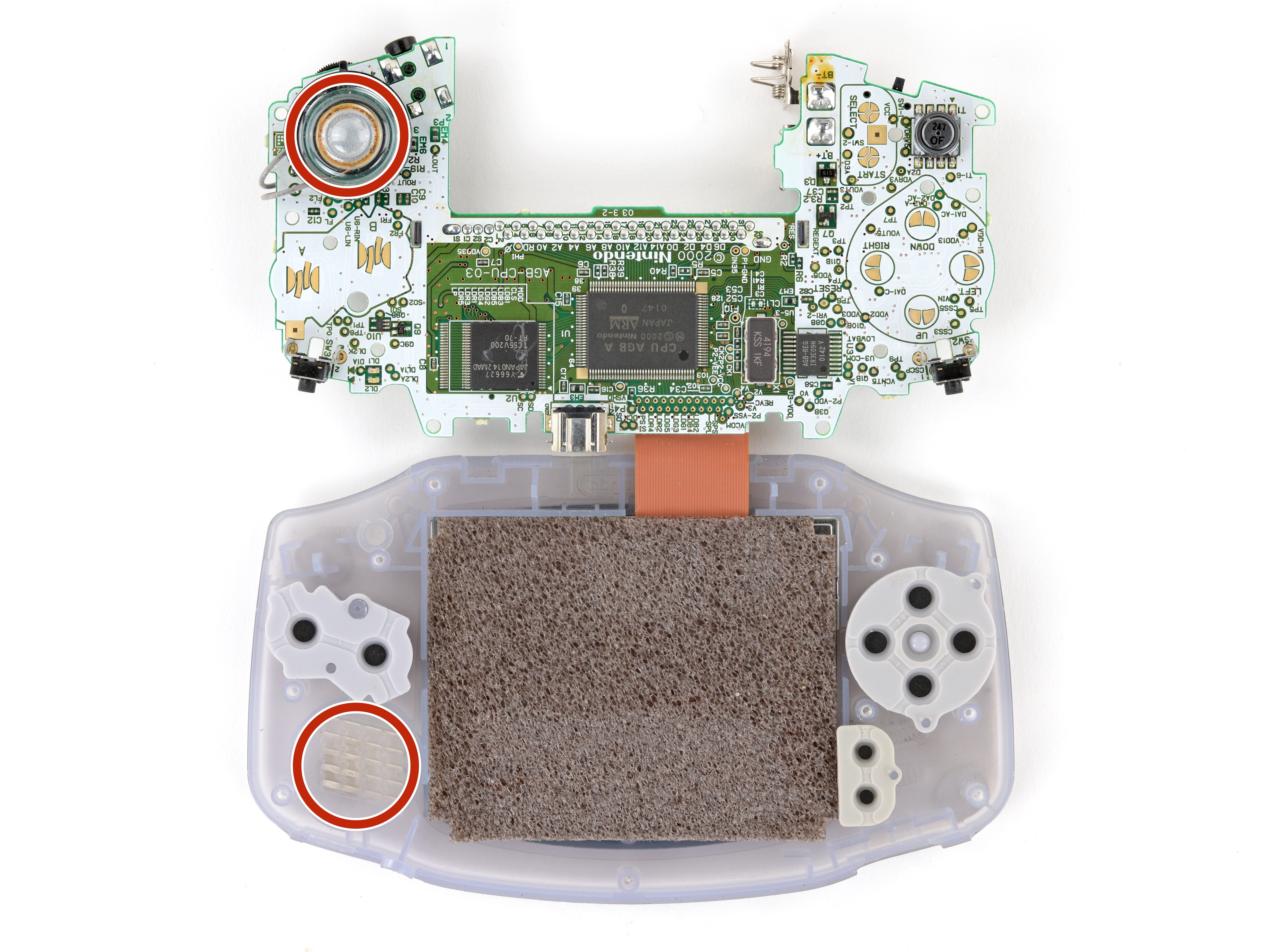

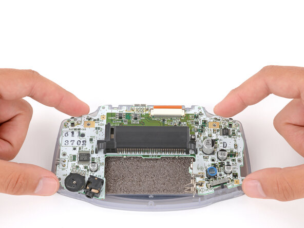

    1. Game Boy Advance LCD Screen Replacement, Remove the motherboard screws: crwdns2935265:09crwdnd2935265:01crwdnd2935265:02crwdne2935265:0 Game Boy Advance LCD Screen Replacement, Remove the motherboard screws: crwdns2935265:09crwdnd2935265:02crwdnd2935265:02crwdne2935265:0
      • Use a JIS 1 screwdriver to remove the three 7 mm‑long screws securing the motherboard.

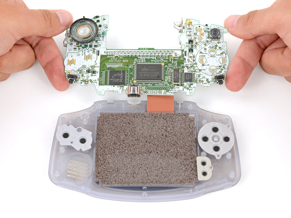

    2. Game Boy Advance LCD Screen Replacement, Reposition the motherboard: crwdns2935265:010crwdnd2935265:01crwdnd2935265:03crwdne2935265:0 Game Boy Advance LCD Screen Replacement, Reposition the motherboard: crwdns2935265:010crwdnd2935265:02crwdnd2935265:03crwdne2935265:0 Game Boy Advance LCD Screen Replacement, Reposition the motherboard: crwdns2935265:010crwdnd2935265:03crwdnd2935265:03crwdne2935265:0
      • Be careful not to strain the screen cable that connects the motherboard.
      • Carefully flip the motherboard over the top edge of your Game Boy and rest it on your work surface.

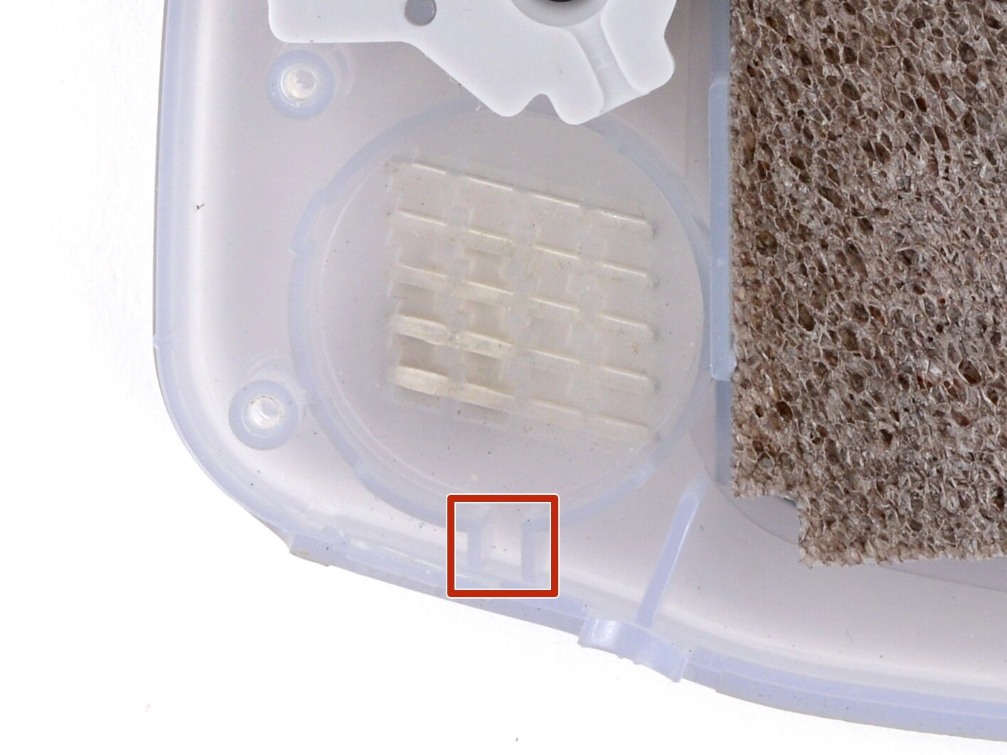

      • During reassembly, make sure the speaker gets correctly slotted into its circular cutout (including a small tab on the bottom) when lowering the motherboard into place.

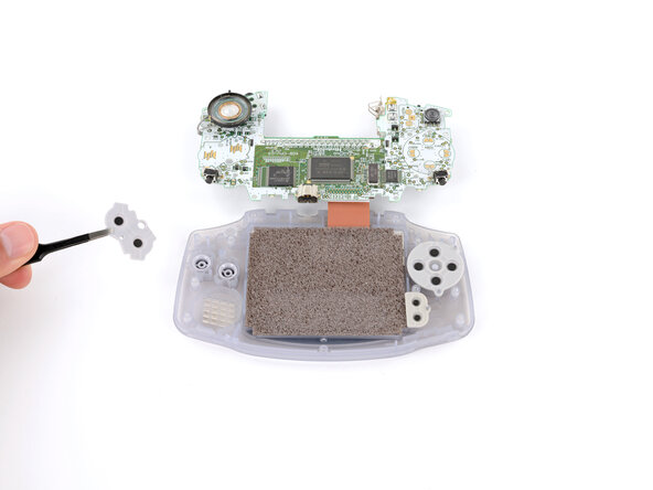

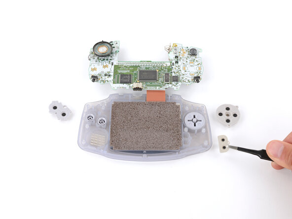

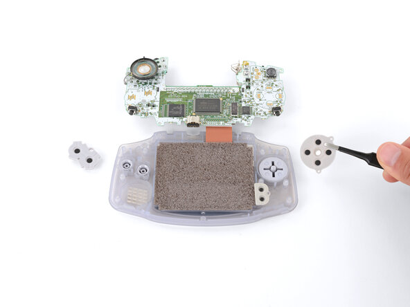

    3. Game Boy Advance LCD Screen Replacement, Remove the silicone pads: crwdns2935265:011crwdnd2935265:01crwdnd2935265:03crwdne2935265:0 Game Boy Advance LCD Screen Replacement, Remove the silicone pads: crwdns2935265:011crwdnd2935265:02crwdnd2935265:03crwdne2935265:0 Game Boy Advance LCD Screen Replacement, Remove the silicone pads: crwdns2935265:011crwdnd2935265:03crwdnd2935265:03crwdne2935265:0
      • Use tweezers or your fingers to remove the three silicone pads covering the buttons (A and B, the D‑pad, and Start/Select ).
      • If any of the pads are missing, they may be stuck to their corresponding spot on the motherboard.
      • During reassembly, use your fingers to press each pad into place, using the alignment pegs to properly orient them.

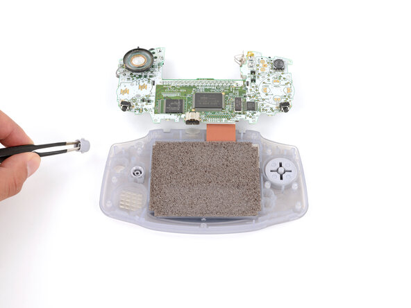

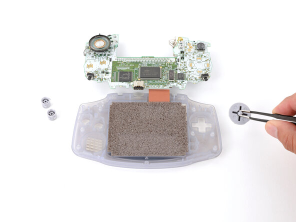

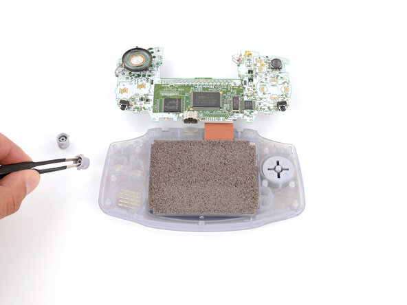

    4. Game Boy Advance LCD Screen Replacement, Remove the action buttons and D‑pad: crwdns2935265:012crwdnd2935265:01crwdnd2935265:03crwdne2935265:0 Game Boy Advance LCD Screen Replacement, Remove the action buttons and D‑pad: crwdns2935265:012crwdnd2935265:02crwdnd2935265:03crwdne2935265:0 Game Boy Advance LCD Screen Replacement, Remove the action buttons and D‑pad: crwdns2935265:012crwdnd2935265:03crwdnd2935265:03crwdne2935265:0
      • Use tweezers or your fingers to remove the buttons (A and B as well as the D‑pad).
      • The Start/Select buttons are part of the silicone pad—there are no other buttons to remove.
      • When re‑inserting the action buttons, note that each one is keyed specifically for its recess and proper orientation.
    1. Game Boy Advance LCD Screen Replacement, LCD Screen: crwdns2935265:013crwdnd2935265:01crwdnd2935265:03crwdne2935265:0 Game Boy Advance LCD Screen Replacement, LCD Screen: crwdns2935265:013crwdnd2935265:02crwdnd2935265:03crwdne2935265:0 Game Boy Advance LCD Screen Replacement, LCD Screen: crwdns2935265:013crwdnd2935265:03crwdnd2935265:03crwdne2935265:0
      • Use a spudger/tweezers/fingernail to unlatch the LCD ribbon port by pulling the grey tabs on the sides upwards (towards the top edge of the PCB).
      • Once the LCD ribbon port has been unlatched, the LCD ribbon should very easily slide out and can be removed with zero force using fingers or tweezers.
    2. Game Boy Advance LCD Screen Replacement: crwdns2935265:014crwdnd2935265:01crwdnd2935265:03crwdne2935265:0 Game Boy Advance LCD Screen Replacement: crwdns2935265:014crwdnd2935265:02crwdnd2935265:03crwdne2935265:0 Game Boy Advance LCD Screen Replacement: crwdns2935265:014crwdnd2935265:03crwdnd2935265:03crwdne2935265:0
      • Use the spudger to lift the screen from the front panel. Place the spudger in the space directly left of the D-pad.
      • The screen and the front panel is connected by a black tape that could rip if not removed carefully.
