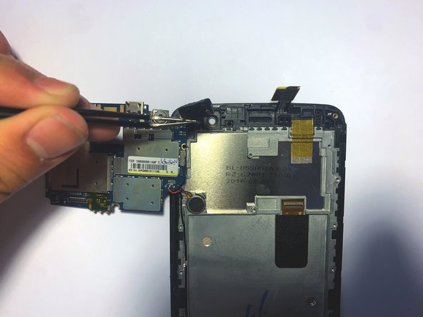

  5. Fusion5 5.5 Gen II Top Speaker Replacement: crwdns2935265:05crwdnd2935265:01crwdnd2935265:01crwdne2935265:0
    • Remove the two 3mm Phillips #00 screws from the motherboard.
  6. Fusion5 5.5 Gen II Top Speaker Replacement: crwdns2935265:06crwdnd2935265:01crwdnd2935265:01crwdne2935265:0
    • Grab the motherboard from the right edges.
    • Flip the motherboard to the left side of the device.
    • Be careful not to tear the cables attached to the motherboard as you flip the motherboard.
    • Desolder the red and blue wires to remove the motherboard from the device.
  7. Fusion5 5.5 Gen II Top Speaker Replacement, Top Speaker: crwdns2935265:07crwdnd2935265:01crwdnd2935265:02crwdne2935265:0 Fusion5 5.5 Gen II Top Speaker Replacement, Top Speaker: crwdns2935265:07crwdnd2935265:02crwdnd2935265:02crwdne2935265:0
    • Using tweezers, grasp the speaker at the top of the phone and gently pull it out of the device.
