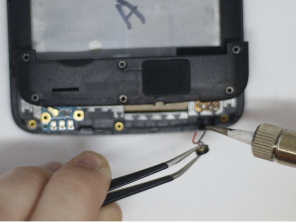

  3. Fusion5 5.5 Gen II Microphone Replacement: crwdns2935265:03crwdnd2935265:01crwdnd2935265:01crwdne2935265:0
    • Using the tweezers, grasp the microphone and remove it from its socket on the device.
    • Straighten out the wires to make the next step easier.

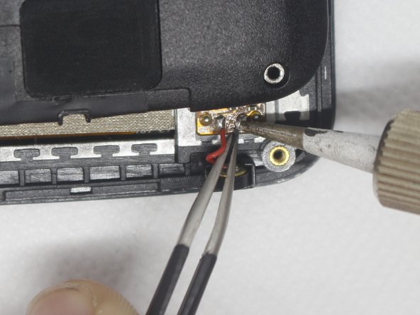

    • Rotate the device or have the bottom of the device facing you for easier access while soldering.
    • Using the tweezers and soldering iron, remove the red and black wires from the circuit board.
    • Make sure that the red wire is on the left connector and the black wire is on the right connector when you solder on the replacement component.
