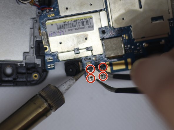

  7. Fusion5 5.5 Gen II Charging Port Replacement, Charging Port: crwdns2935265:07crwdnd2935265:01crwdnd2935265:02crwdne2935265:0 Fusion5 5.5 Gen II Charging Port Replacement, Charging Port: crwdns2935265:07crwdnd2935265:02crwdnd2935265:02crwdne2935265:0
    • Using the tweezers and soldering iron, desolder the charging port at all 4 soldering points on each corner of the charging port.
    • Be careful not to damage the front-facing camera with the solder as it lays next to the charging port.
    • The device is rotated upside down here for ease of accessibility.
