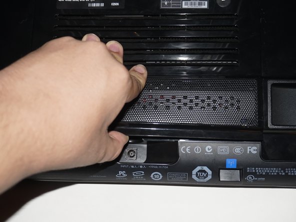

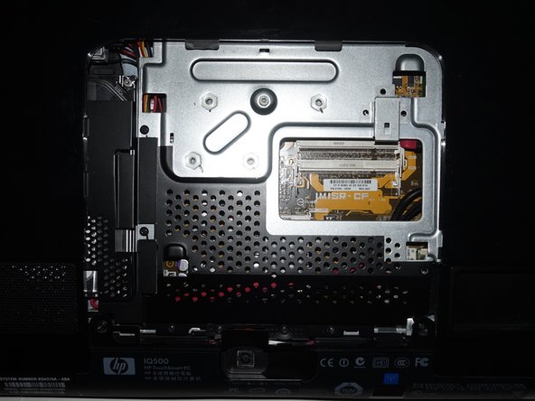

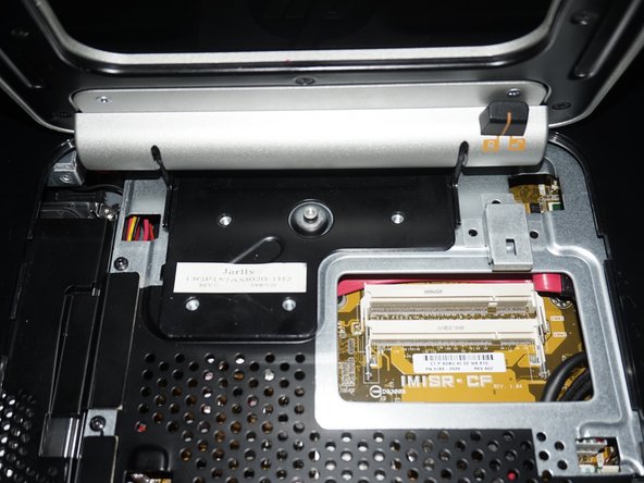

  4. Full method - HP Touchsmart IQ506 CMOS Battery Replacement, Remove the RAM door: crwdns2935265:04crwdnd2935265:01crwdnd2935265:03crwdne2935265:0 Full method - HP Touchsmart IQ506 CMOS Battery Replacement, Remove the RAM door: crwdns2935265:04crwdnd2935265:02crwdnd2935265:03crwdne2935265:0 Full method - HP Touchsmart IQ506 CMOS Battery Replacement, Remove the RAM door: crwdns2935265:04crwdnd2935265:03crwdnd2935265:03crwdne2935265:0
    • Remove the screw on the RAM door. Once you remove the screw, unclip the door.

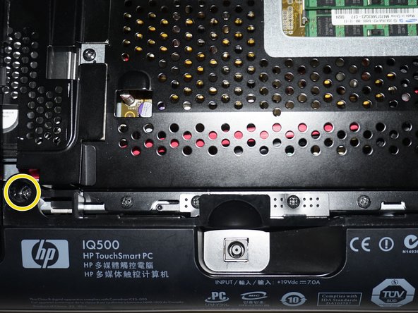

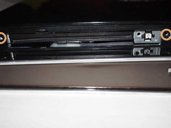

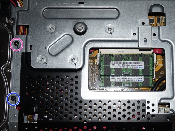

  7. Full method - HP Touchsmart IQ506 CMOS Battery Replacement, Remove the I/O panel screws: crwdns2935265:07crwdnd2935265:01crwdnd2935265:03crwdne2935265:0 Full method - HP Touchsmart IQ506 CMOS Battery Replacement, Remove the I/O panel screws: crwdns2935265:07crwdnd2935265:02crwdnd2935265:03crwdne2935265:0 Full method - HP Touchsmart IQ506 CMOS Battery Replacement, Remove the I/O panel screws: crwdns2935265:07crwdnd2935265:03crwdnd2935265:03crwdne2935265:0
    • Remove the 3 screws in the I/O bay of the system.
    • Remove the 2 screws from under the RAM panel. Note: My system is missing a screw, but it is marked accordingly. Yoy may or may not need to keep this in mind.
    • Remove the 2 screws from under the ODD cover. Tip: If you are having trouble with this cover, use a spudger or plastic pry tool to remove it.

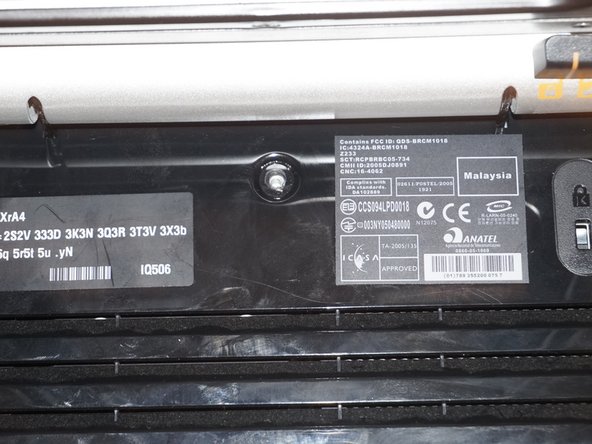

    • NOTE: ONE SCREW NOT SHOWN DUE TO PHOTO LIMIT. Remove the 2 screws above the model number palte.

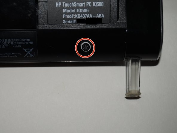

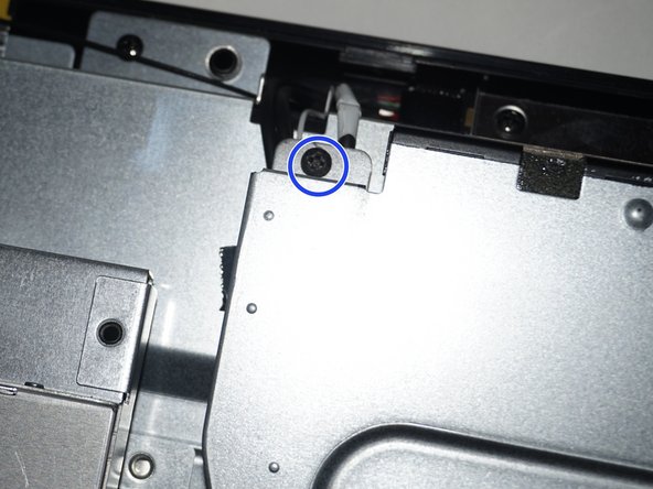

  8. Full method - HP Touchsmart IQ506 CMOS Battery Replacement, Remove the screws from the system 2: crwdns2935265:08crwdnd2935265:01crwdnd2935265:02crwdne2935265:0 Full method - HP Touchsmart IQ506 CMOS Battery Replacement, Remove the screws from the system 2: crwdns2935265:08crwdnd2935265:02crwdnd2935265:02crwdne2935265:0
    • Remove the 2 screws by the feet on the system chassis.

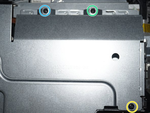

  10. Full method - HP Touchsmart IQ506 CMOS Battery Replacement, Remove the motherboard shield: crwdns2935265:010crwdnd2935265:01crwdnd2935265:03crwdne2935265:0 Full method - HP Touchsmart IQ506 CMOS Battery Replacement, Remove the motherboard shield: crwdns2935265:010crwdnd2935265:02crwdnd2935265:03crwdne2935265:0 Full method - HP Touchsmart IQ506 CMOS Battery Replacement, Remove the motherboard shield: crwdns2935265:010crwdnd2935265:03crwdnd2935265:03crwdne2935265:0
    • The metal EMI shield over the power jack has to be removed to pull the motherboard shield off. This must be replaced when reassembling the system.
    • Remove the 7 screws to reveal the motherboard and other major components. Use a Phillips #1 screwdriver to do this.

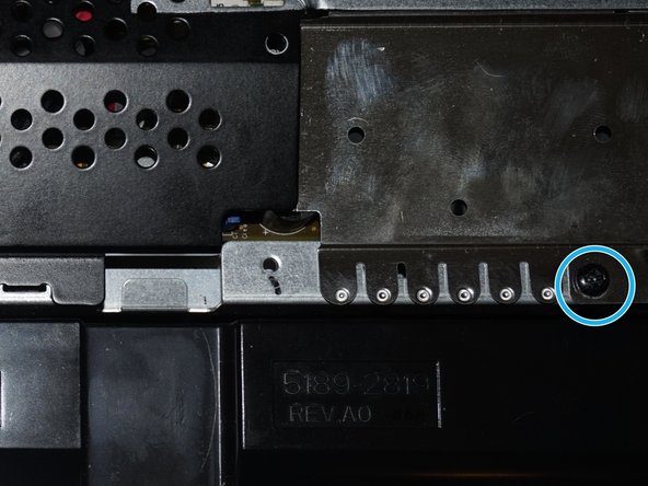

  12. Full method - HP Touchsmart IQ506 CMOS Battery Replacement, Remove the battery: crwdns2935265:012crwdnd2935265:01crwdnd2935265:03crwdne2935265:0 Full method - HP Touchsmart IQ506 CMOS Battery Replacement, Remove the battery: crwdns2935265:012crwdnd2935265:02crwdnd2935265:03crwdne2935265:0 Full method - HP Touchsmart IQ506 CMOS Battery Replacement, Remove the battery: crwdns2935265:012crwdnd2935265:03crwdnd2935265:03crwdne2935265:0
    • If you want to track when you replaced the battery, put a mark on the battery with the month and year so you know when it was replaced. If you cannot write on the battery, putting a hidden note under the memory panel is also an option.
    • Optional: Put a note on the RAM door out of sight or write when the battery was replaced on the new battery.
    • Push the tab on the battery in and then remove it. Put the new battery in the reverse way of removal. Once this is done, write when the battery was replaced (Example: 5/16) on the battery.
