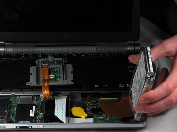

      • Flip the laptop over and open it facing you.
      • The cover is connected to the inner computer with an aluminum strip, so be careful lifting it.
      • Use a plastic opening tool to lift the bottom black cover on both sides.
      • For the proceeding steps, put on an anti-static wrist strap to protect the delicate circuitry inside the computer. To learn how to use the anti-static wrist strap, click here.
    3. Fujitsu LIFEBOOK P7010D Hard Drive Replacement: crwdns2935265:07crwdnd2935265:01crwdnd2935265:03crwdne2935265:0 Fujitsu LIFEBOOK P7010D Hard Drive Replacement: crwdns2935265:07crwdnd2935265:02crwdnd2935265:03crwdne2935265:0 Fujitsu LIFEBOOK P7010D Hard Drive Replacement: crwdns2935265:07crwdnd2935265:03crwdnd2935265:03crwdne2935265:0

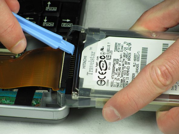

      • The hard drive is connected with a strip, so be careful when lifting it out.
      • Once the black cover is lifted, gently flip it and set it on the keyboard.
      • Locate the disc drive on the right side, as pictured.
      • Using two fingers and the clear plastic handles on the top, gently lift it out. Place it on the side of the laptop.
    4. Fujitsu LIFEBOOK P7010D Hard Drive Replacement: crwdns2935265:08crwdnd2935265:01crwdnd2935265:03crwdne2935265:0 Fujitsu LIFEBOOK P7010D Hard Drive Replacement: crwdns2935265:08crwdnd2935265:02crwdnd2935265:03crwdne2935265:0 Fujitsu LIFEBOOK P7010D Hard Drive Replacement: crwdns2935265:08crwdnd2935265:03crwdnd2935265:03crwdne2935265:0
      • Flip the hard drive on its side.
      • The pins connected to the hard drive are extremely fragile. Take care in handling the next few steps.
      • Hold the hard drive and insert a plastic opening tool, preferably a wider one, in between the black pin holder and the hard drive.
      • Gently wiggle the black pin holder back and forth, on each side, until it comes off.
