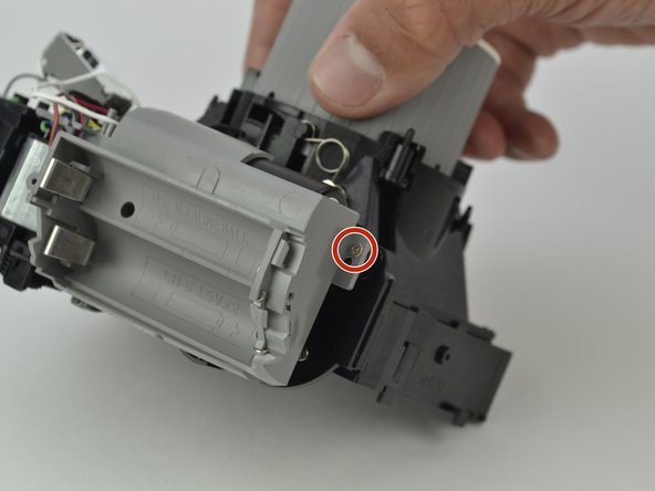

    • Use a spudger to remove the film slot guard on the top of the camera.
    • Remove the one 4.5 mm #00 Phillips screw under the slot guard.

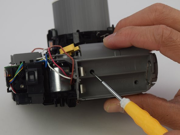

    • Remove the four 4.5 mm screws inside the battery holder with a long #00 Phillips screwdriver.

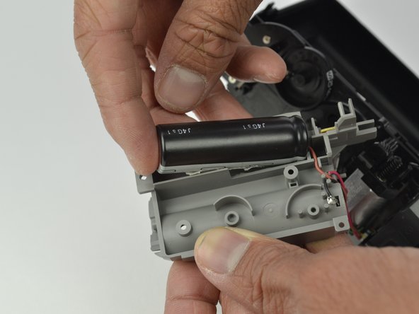

    • Gently pull on the battery holder to remove it from the case, exposing the capacitor.
    • Pull up on the backside of the capacitor to remove it from the battery holder.
    • The capacitor will have a small amount of adhesive holding it onto the battery holder. Keep this intact, but don't worry if it is damaged.
    • Be careful not to touch the wire leads on the front of the capacitor, as you could get shocked.

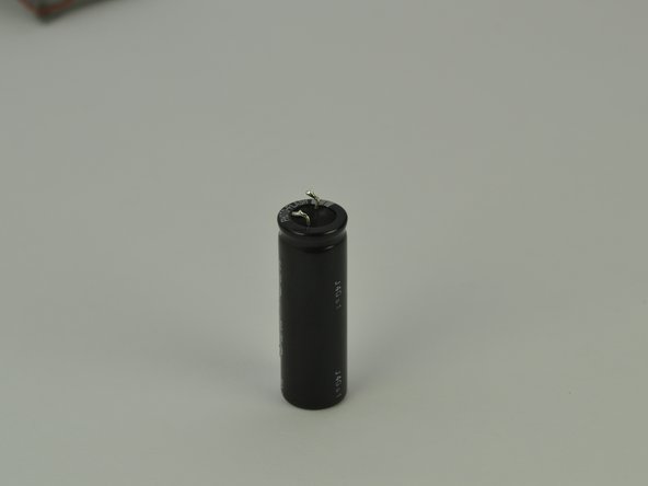

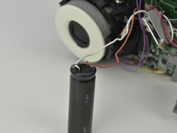

    • Desolder the ends of the wires from the leads of the capacitor to remove it.
    • Take note of the connections between the wires and leads for reassembly. The brown wire connects to side with white line and the white wire connects to the other side.
    • Be careful not to touch both leads of the capacitor with your soldering iron. This will bridge the connection and could create a spark.
