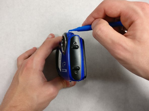

    • Pry the black bottom plate off using a plastic opening tool.
    • It is easier to start on the side of the open battery compartment.
  8. Fujifilm FinePix XP70 Front and Back Panel Replacement: crwdns2935265:08crwdnd2935265:01crwdnd2935265:02crwdne2935265:0 Fujifilm FinePix XP70 Front and Back Panel Replacement: crwdns2935265:08crwdnd2935265:02crwdnd2935265:02crwdne2935265:0
    • Pry the front plate off using a plastic opening tool.
    • It's recommended to start at the ridge on the top or bottom side.
  9. Fujifilm FinePix XP70 Front and Back Panel Replacement: crwdns2935265:09crwdnd2935265:01crwdnd2935265:01crwdne2935265:0
    • Lift off the front plate.
  10. Fujifilm FinePix XP70 Front and Back Panel Replacement: crwdns2935265:010crwdnd2935265:01crwdnd2935265:03crwdne2935265:0 Fujifilm FinePix XP70 Front and Back Panel Replacement: crwdns2935265:010crwdnd2935265:02crwdnd2935265:03crwdne2935265:0 Fujifilm FinePix XP70 Front and Back Panel Replacement: crwdns2935265:010crwdnd2935265:03crwdnd2935265:03crwdne2935265:0
    • Pry the back plate off with a plastic opening tool
