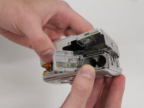

    • Locate the battery hatch on the bottom side of the camera, opposite the side with the power button.
    • Using your thumb, slide the hatch away from the center of the camera.
    • Flip the hatch toward yourself to open it. The batteries are spring-loaded; once the hatch is open, they will protrude far enough to be removed by hand.

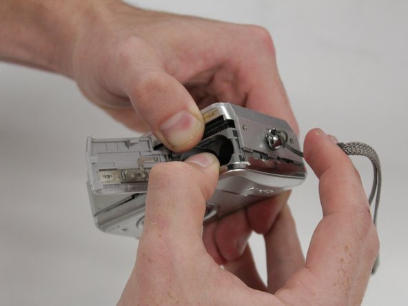

    • Locate the memory card in the long, thin slot above the battery compartment.
    • Using your thumb, push the memory card farther into the camera.
    • The memory card is spring-loaded and will pop out of the camera far enough to be removed by hand.

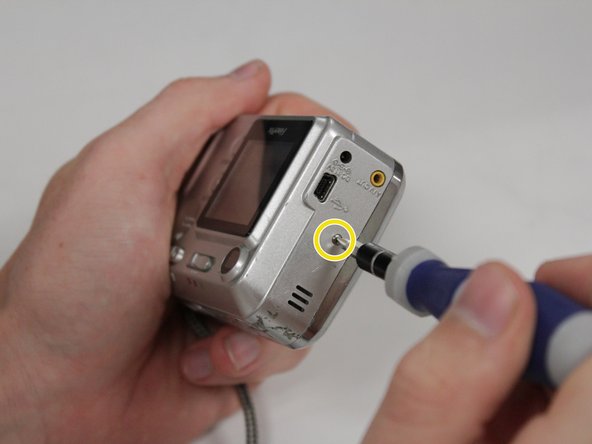

    • Locate the two 5.0 mm screws on the bottom of the camera and remove them using a tri-point screwdriver with a Y0 bit.
    • Locate the two 3.0 mm screws on the side of the camera with the wrist strap and remove them using a tri-point screwdriver with a Y0 bit.
    • Locate the single 5.0 mm screw on the opposite side of the camera and remove it using a tri-point screwdriver with a Y0 bit.

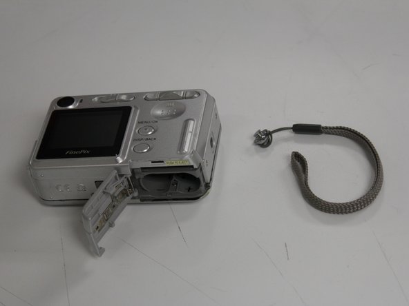

  4. Fujifilm FinePix A350 Speaker Replacement: crwdns2935265:04crwdnd2935265:01crwdnd2935265:03crwdne2935265:0 Fujifilm FinePix A350 Speaker Replacement: crwdns2935265:04crwdnd2935265:02crwdnd2935265:03crwdne2935265:0 Fujifilm FinePix A350 Speaker Replacement: crwdns2935265:04crwdnd2935265:03crwdnd2935265:03crwdne2935265:0
    • Ensure that the batteries are removed and the camera is not connected to any external power source. Never touch any part of the interior of the device when powered.
    • Pry the case apart. Note that the case is very tightly sealed and will be difficult to open. Use a plastic opening tool on the crease between the two halves of the case and put two fingers in the battery compartment to create leverage to pull apart. The battery compartment is attached to the half of the case that contains the lens.
    • Once the two halves of the case have begun to come apart, pull the wrist strap away from the front of the camera to remove it.
