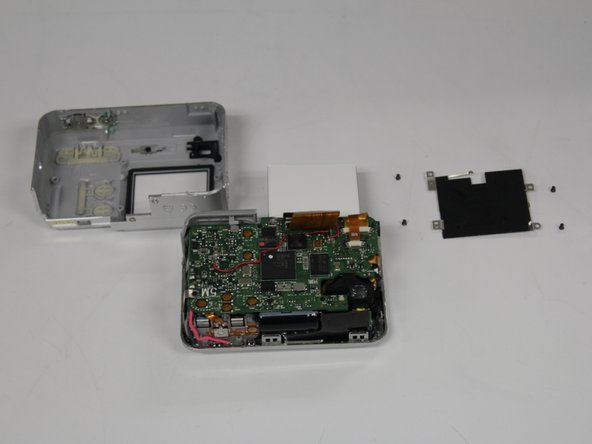

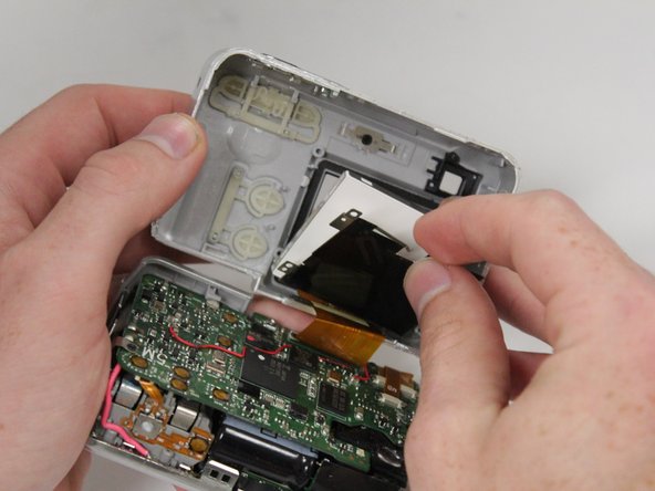

  7. Fujifilm FinePix A350 Motherboard Replacement, LCD Screen: crwdns2935265:07crwdnd2935265:01crwdnd2935265:03crwdne2935265:0 Fujifilm FinePix A350 Motherboard Replacement, LCD Screen: crwdns2935265:07crwdnd2935265:02crwdnd2935265:03crwdne2935265:0 Fujifilm FinePix A350 Motherboard Replacement, LCD Screen: crwdns2935265:07crwdnd2935265:03crwdnd2935265:03crwdne2935265:0
    • Locate the four 3.0 mm screws holding a thin, black plastic film to the back of the LCD screen. Remove them using a Phillips screwdriver with a #0 bit.
    • After the screws have been removed, the black plastic film and LCD screen can be removed by lifting up the end opposite the attached ribbon cable.
  8. Fujifilm FinePix A350 Motherboard Replacement: crwdns2935265:08crwdnd2935265:01crwdnd2935265:02crwdne2935265:0 Fujifilm FinePix A350 Motherboard Replacement: crwdns2935265:08crwdnd2935265:02crwdnd2935265:02crwdne2935265:0
    • Locate the wide ribbon cable connecting the screen to the motherboard.
    • Place your thumb at the base of the ribbon cable where it connects to the motherboard. Carefully pull the ribbon cable out of its connector without pulling it up or away from the motherboard.
    • The ribbon cable should detach from the motherboard but remain connected to the screen, which can now be removed from the camera.

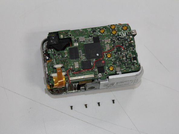

  9. Fujifilm FinePix A350 Motherboard Replacement, Motherboard: crwdns2935265:09crwdnd2935265:01crwdnd2935265:02crwdne2935265:0 Fujifilm FinePix A350 Motherboard Replacement, Motherboard: crwdns2935265:09crwdnd2935265:02crwdnd2935265:02crwdne2935265:0
    • Locate four black 3.0 mm screws on the motherboard and remove them using a Phillips screwdriver with a #0 bit.

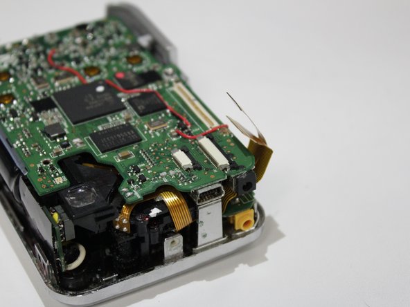

  10. Fujifilm FinePix A350 Motherboard Replacement: crwdns2935265:010crwdnd2935265:01crwdnd2935265:03crwdne2935265:0 Fujifilm FinePix A350 Motherboard Replacement: crwdns2935265:010crwdnd2935265:02crwdnd2935265:03crwdne2935265:0 Fujifilm FinePix A350 Motherboard Replacement: crwdns2935265:010crwdnd2935265:03crwdnd2935265:03crwdne2935265:0

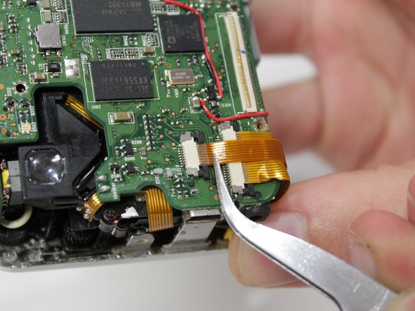

    • Locate the two orange ribbon cables next to the LCD screen connector. Starting with the smaller cable, use a pair of tweezers to slide the two ends of the black clamp away from the pale plastic connector.
    • Use tweezers to carefully remove the smaller cable from its connector.

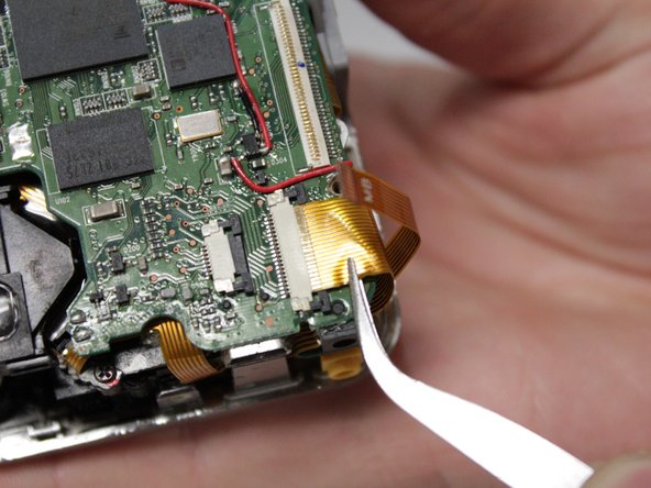

  11. Fujifilm FinePix A350 Motherboard Replacement: crwdns2935265:011crwdnd2935265:01crwdnd2935265:03crwdne2935265:0 Fujifilm FinePix A350 Motherboard Replacement: crwdns2935265:011crwdnd2935265:02crwdnd2935265:03crwdne2935265:0 Fujifilm FinePix A350 Motherboard Replacement: crwdns2935265:011crwdnd2935265:03crwdnd2935265:03crwdne2935265:0
    • Use tweezers to slide the two ends of the black clamp away from the pale plastic connector of the larger ribbon cable.
    • Use tweezers to carefully remove the larger cable from its connector.

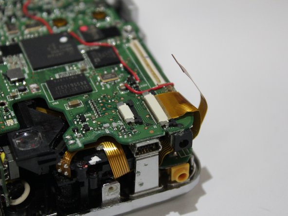

  12. Fujifilm FinePix A350 Motherboard Replacement: crwdns2935265:012crwdnd2935265:01crwdnd2935265:02crwdne2935265:0 Fujifilm FinePix A350 Motherboard Replacement: crwdns2935265:012crwdnd2935265:02crwdnd2935265:02crwdne2935265:0
    • Locate a third ribbon cable, near the previous two, but on the underside of the motherboard.
    • Slightly raise the motherboard to access the ribbon cable with a pair of tweezers. Remove the cable from its connector, following the same procedure as above.

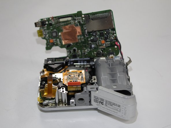

    • Once these three ribbon cables have been removed, the motherboard will be connected to the case only by a fourth ribbon cable and a pair of red and black wires in one corner.
  13. Fujifilm FinePix A350 Motherboard Replacement: crwdns2935265:013crwdnd2935265:01crwdnd2935265:03crwdne2935265:0 Fujifilm FinePix A350 Motherboard Replacement: crwdns2935265:013crwdnd2935265:02crwdnd2935265:03crwdne2935265:0 Fujifilm FinePix A350 Motherboard Replacement: crwdns2935265:013crwdnd2935265:03crwdnd2935265:03crwdne2935265:0

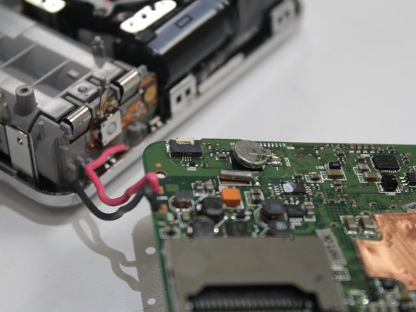

    • Separate the motherboard from the case by pulling directly upward. Some resistance is normal; the board is loosely held in place by plastic notches and grooves. It will still be connected via a pair of red and black wires and a fourth small ribbon cable.
    • Locate the fourth ribbon cable on the underside of the motherboard where the red and black wires connect to the battery compartment. Unlike the previous ribbon cables, the clamp is white and the connector is black. Use tweezers to loosen the white clamp before disconnecting the ribbon cable.
    • To completely remove the board, use a soldering iron to desolder the red and black wires connecting the motherboard to the battery compartment. Note the black wire goes to the terminal closest to the memory card slot.
    • If you lack experience in soldering, or need a refresher, refer to the iFixit soldering guide.
    • Desoldering the motherboard is not a prerequisite for subsequent guides.
