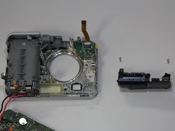

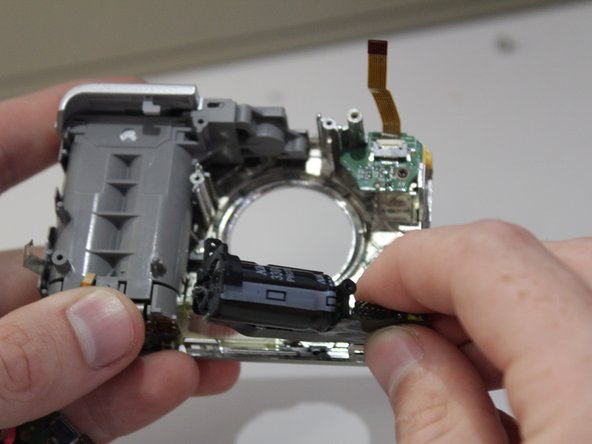

    1. Fujifilm FinePix A350 Flash Unit Replacement, Flash Unit: crwdns2935265:016crwdnd2935265:01crwdnd2935265:03crwdne2935265:0 Fujifilm FinePix A350 Flash Unit Replacement, Flash Unit: crwdns2935265:016crwdnd2935265:02crwdnd2935265:03crwdne2935265:0 Fujifilm FinePix A350 Flash Unit Replacement, Flash Unit: crwdns2935265:016crwdnd2935265:03crwdnd2935265:03crwdne2935265:0
      • Locate the two 4.0 mm screws that hold the flash unit and remove them using a Phillips #0 screwdriver .
      • Remove the flash unit by grasping the chip (not the attached capacitor) and lifting it up from the case of the camera.
