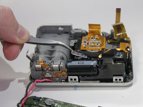

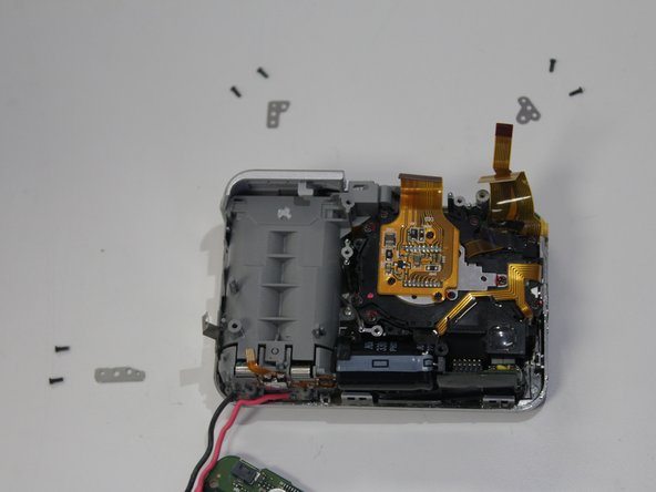

  14. Fujifilm FinePix A350 AV Port Replacement, Lens: crwdns2935265:014crwdnd2935265:01crwdnd2935265:03crwdne2935265:0 Fujifilm FinePix A350 AV Port Replacement, Lens: crwdns2935265:014crwdnd2935265:02crwdnd2935265:03crwdne2935265:0 Fujifilm FinePix A350 AV Port Replacement, Lens: crwdns2935265:014crwdnd2935265:03crwdnd2935265:03crwdne2935265:0
    • Locate the six 4.0 mm screws securing the three metal brackets to the lens assembly. Remove them using a Phillips screwdriver with a #0 bit.
    • Use tweezers to remove the three metal brackets underneath the screws.

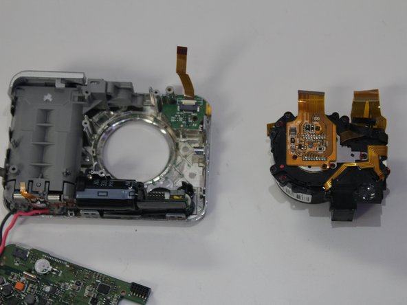

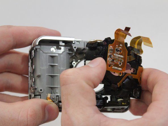

  15. Fujifilm FinePix A350 AV Port Replacement: crwdns2935265:015crwdnd2935265:01crwdnd2935265:03crwdne2935265:0 Fujifilm FinePix A350 AV Port Replacement: crwdns2935265:015crwdnd2935265:02crwdnd2935265:03crwdne2935265:0 Fujifilm FinePix A350 AV Port Replacement: crwdns2935265:015crwdnd2935265:03crwdnd2935265:03crwdne2935265:0
    • Grasp the lens assembly and carefully lift it out of the camera.

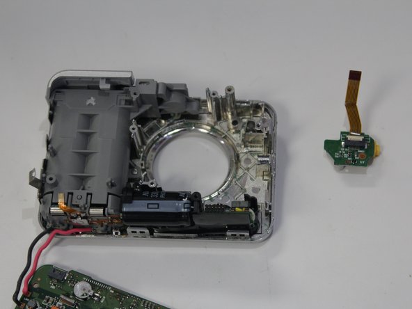

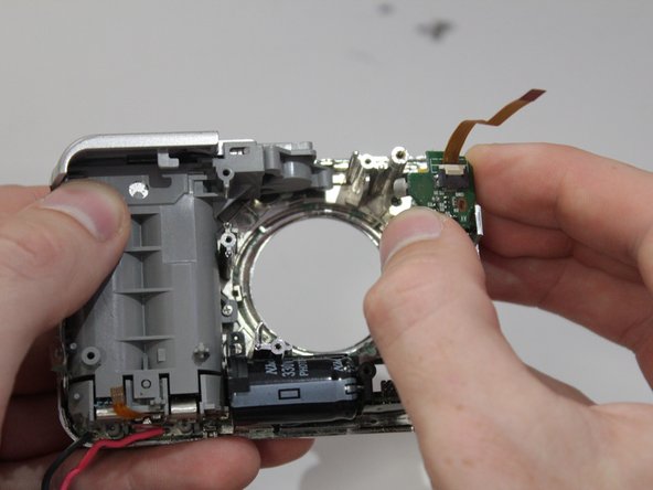

  16. Fujifilm FinePix A350 AV Port Replacement, AV Port: crwdns2935265:016crwdnd2935265:01crwdnd2935265:03crwdne2935265:0 Fujifilm FinePix A350 AV Port Replacement, AV Port: crwdns2935265:016crwdnd2935265:02crwdnd2935265:03crwdne2935265:0 Fujifilm FinePix A350 AV Port Replacement, AV Port: crwdns2935265:016crwdnd2935265:03crwdnd2935265:03crwdne2935265:0
    • Locate the single 3.0 mm screw holding the AV port to the case and remove it using a Phillips screwdriver with a #0 bit.
    • Using your thumb and forefinger, carefully lift the AV port and its chip up from the case of the camera.
