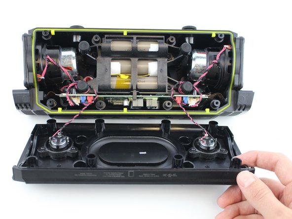

  5. Fugoo Tough XL Battery Replacement: crwdns2935265:05crwdnd2935265:01crwdnd2935265:01crwdne2935265:0
    • Slowly pull the front casing from the back casing. Avoid putting any tension on the connected cables.
    • Separate the two slowly and consistently to avoid damaging the speaker cables.
  6. Fugoo Tough XL Battery Replacement, Motherboard: crwdns2935265:06crwdnd2935265:01crwdnd2935265:02crwdne2935265:0 Fugoo Tough XL Battery Replacement, Motherboard: crwdns2935265:06crwdnd2935265:02crwdnd2935265:02crwdne2935265:0
    • Carefully untangle the wires that connect the speaker to the motherboard.

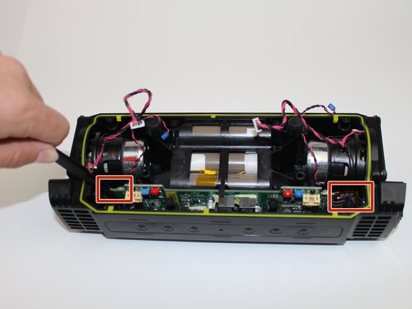

  7. Fugoo Tough XL Battery Replacement: crwdns2935265:07crwdnd2935265:01crwdnd2935265:02crwdne2935265:0 Fugoo Tough XL Battery Replacement: crwdns2935265:07crwdnd2935265:02crwdnd2935265:02crwdne2935265:0
    • Use tweezers to remove the two ribbon wires on the left and right side of motherboard.
    • Do not pull the cables by the cord, as this could damage the cables and the motherboard. It is best to always disconnect the cables from the base, which is closest to the motherboard, using an iFixit opening tool.

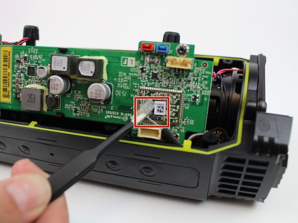

  8. Fugoo Tough XL Battery Replacement: crwdns2935265:08crwdnd2935265:01crwdnd2935265:02crwdne2935265:0 Fugoo Tough XL Battery Replacement: crwdns2935265:08crwdnd2935265:02crwdnd2935265:02crwdne2935265:0
    • There is a hidden ribbon on the motherboard, that becomes visible once the motherboard has been pulled out.
    • Pull the motherboard halfway out.
    • Gently unplug the ribbon using tweezers.
