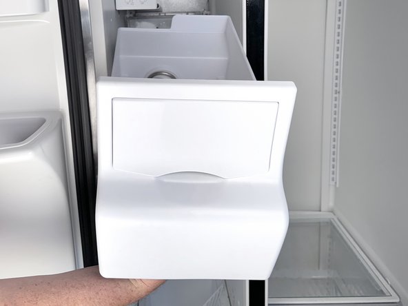

  2. Frigidaire Side-By-Side Refrigerator Evaporator Fan Cover Removal, Remove the ice bin: crwdns2935265:02crwdnd2935265:01crwdnd2935265:02crwdne2935265:0 Frigidaire Side-By-Side Refrigerator Evaporator Fan Cover Removal, Remove the ice bin: crwdns2935265:02crwdnd2935265:02crwdnd2935265:02crwdne2935265:0
    • Open the freezer door.
    • Grasp the lower portion of the front of the ice bin.
    • Lift it slightly and pull it out toward the front of the refrigerator.

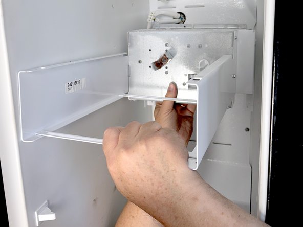

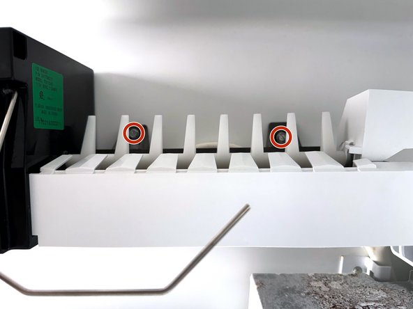

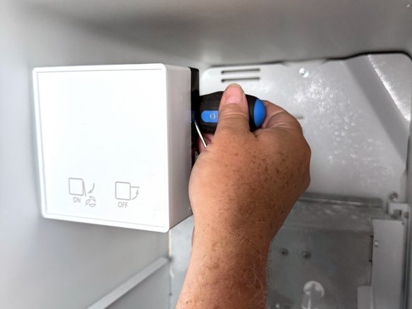

  3. Frigidaire Side-By-Side Refrigerator Evaporator Fan Cover Removal, Unfasten the ice maker: crwdns2935265:03crwdnd2935265:01crwdnd2935265:03crwdne2935265:0 Frigidaire Side-By-Side Refrigerator Evaporator Fan Cover Removal, Unfasten the ice maker: crwdns2935265:03crwdnd2935265:02crwdnd2935265:03crwdne2935265:0 Frigidaire Side-By-Side Refrigerator Evaporator Fan Cover Removal, Unfasten the ice maker: crwdns2935265:03crwdnd2935265:03crwdnd2935265:03crwdne2935265:0
    • These screws are challenging to reach.
    • Use a 1/4" nut driver to remove the two screws securing the ice maker to the sidewall of the freezer compartment.

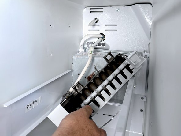

  4. Frigidaire Side-By-Side Refrigerator Evaporator Fan Cover Removal, Reposition the ice maker: crwdns2935265:04crwdnd2935265:01crwdnd2935265:02crwdne2935265:0 Frigidaire Side-By-Side Refrigerator Evaporator Fan Cover Removal, Reposition the ice maker: crwdns2935265:04crwdnd2935265:02crwdnd2935265:02crwdne2935265:0
    • Rotate the ice maker to the right and lower the front end to access the cable.

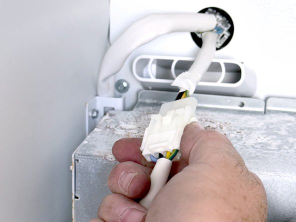

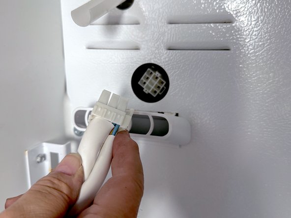

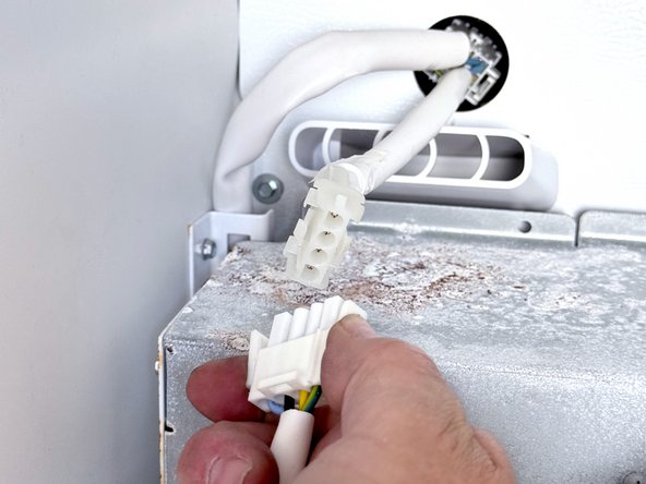

  5. Frigidaire Side-By-Side Refrigerator Evaporator Fan Cover Removal, Disconnect the icemaker: crwdns2935265:05crwdnd2935265:01crwdnd2935265:03crwdne2935265:0 Frigidaire Side-By-Side Refrigerator Evaporator Fan Cover Removal, Disconnect the icemaker: crwdns2935265:05crwdnd2935265:02crwdnd2935265:03crwdne2935265:0 Frigidaire Side-By-Side Refrigerator Evaporator Fan Cover Removal, Disconnect the icemaker: crwdns2935265:05crwdnd2935265:03crwdnd2935265:03crwdne2935265:0
    • Locate the ice maker connector near the back of the freezer.
    • Squeeze the release tabs on the connector to release it, and pull it out to disconnect it.
    • You may need to use two hands to do this, one on the rear half and one on the front half of the connector.
    • You can support the ice maker on the ice bin support if you need both hands to disconnect it.

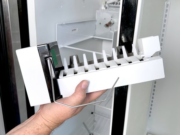

  6. Frigidaire Side-By-Side Refrigerator Evaporator Fan Cover Removal, Remove the ice maker: crwdns2935265:06crwdnd2935265:01crwdnd2935265:02crwdne2935265:0 Frigidaire Side-By-Side Refrigerator Evaporator Fan Cover Removal, Remove the ice maker: crwdns2935265:06crwdnd2935265:02crwdnd2935265:02crwdne2935265:0
    • Remove the ice maker from the freezer compartment.

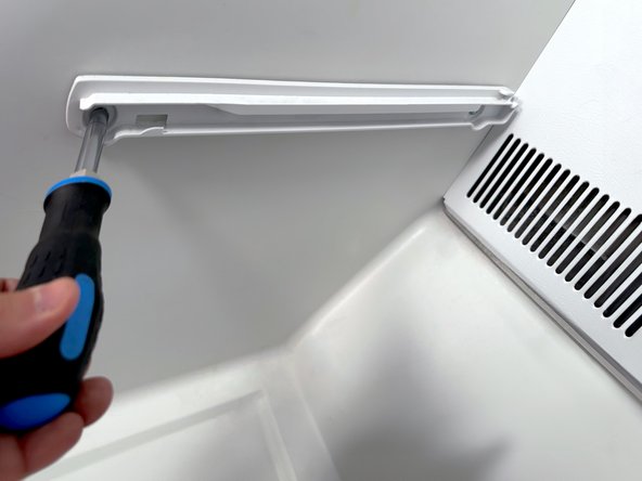

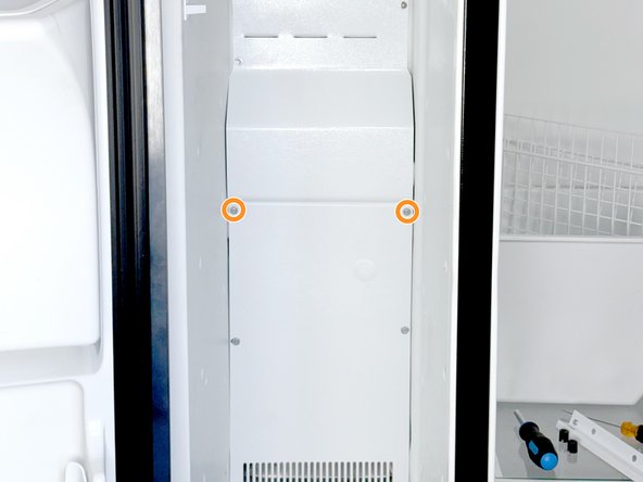

  7. Frigidaire Side-By-Side Refrigerator Evaporator Fan Cover Removal, Remove left side freezer drawer rail: crwdns2935265:07crwdnd2935265:01crwdnd2935265:02crwdne2935265:0 Frigidaire Side-By-Side Refrigerator Evaporator Fan Cover Removal, Remove left side freezer drawer rail: crwdns2935265:07crwdnd2935265:02crwdnd2935265:02crwdne2935265:0
    • Use a 1/4" nut driver to remove the two screws securing the left side freezer drawer rail.
    • Remove the drawer rail

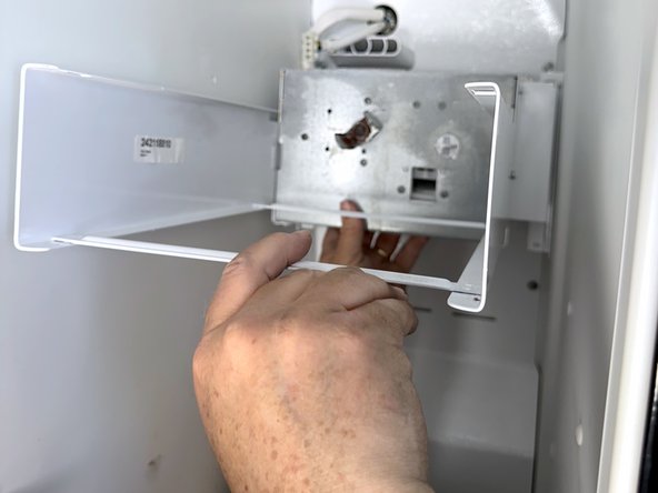

  8. Frigidaire Side-By-Side Refrigerator Evaporator Fan Cover Removal, Unfasten auger motor assembly: crwdns2935265:08crwdnd2935265:01crwdnd2935265:01crwdne2935265:0
    • Use a 1/4" nut driver to remove the two screws securing the auger motor assembly to the support brackets located in the rear of the freezer compartment.

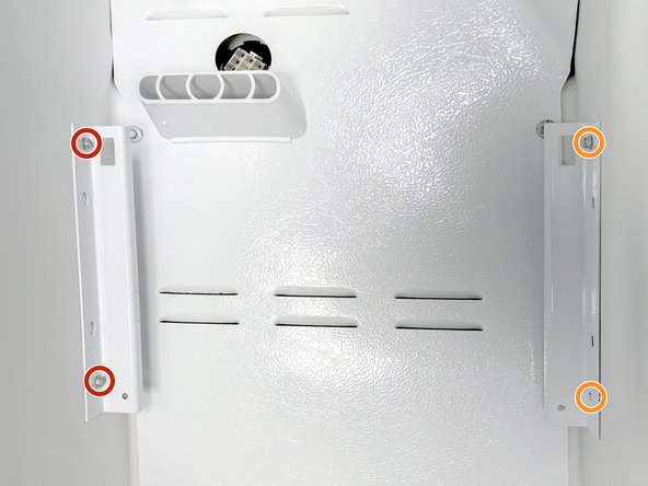

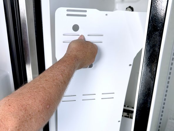

  13. Frigidaire Side-By-Side Refrigerator Evaporator Fan Cover Removal, Unfasten the upper evaporator cover.: crwdns2935265:013crwdnd2935265:01crwdnd2935265:02crwdne2935265:0 Frigidaire Side-By-Side Refrigerator Evaporator Fan Cover Removal, Unfasten the upper evaporator cover.: crwdns2935265:013crwdnd2935265:02crwdnd2935265:02crwdne2935265:0
    • Use a 1/4" nut driver to remove the five screws securing the upper evaporator panel.
    • Use a 1/4" nut driver to remove the two additional screws securing the upper and lower evaporator panels

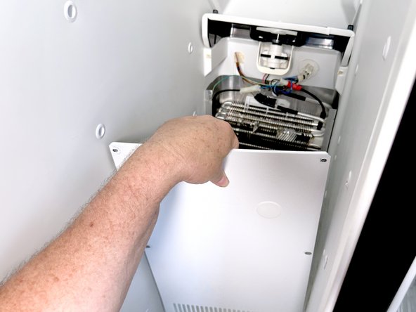

  14. Frigidaire Side-By-Side Refrigerator Evaporator Fan Cover Removal, Remove the upper evaporator cover: crwdns2935265:014crwdnd2935265:01crwdnd2935265:03crwdne2935265:0 Frigidaire Side-By-Side Refrigerator Evaporator Fan Cover Removal, Remove the upper evaporator cover: crwdns2935265:014crwdnd2935265:02crwdnd2935265:03crwdne2935265:0 Frigidaire Side-By-Side Refrigerator Evaporator Fan Cover Removal, Remove the upper evaporator cover: crwdns2935265:014crwdnd2935265:03crwdnd2935265:03crwdne2935265:0
    • Use the hole in the upper evaporator cover to lift the upper evaporator cover off.
    • The sheet metal is sharp, and you should consider gloves to protect your hands. Work carefully.

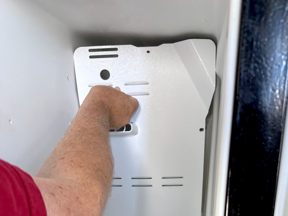

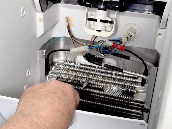

  15. Frigidaire Side-By-Side Refrigerator Evaporator Fan Cover Removal, Unfasten the lower evaporator cover: crwdns2935265:015crwdnd2935265:01crwdnd2935265:01crwdne2935265:0
    • Use a 1/4" nut driver to remove the two remaining screws securing the lower evaporator cover.
  16. Frigidaire Side-By-Side Refrigerator Evaporator Fan Cover Removal, Remove the lower evaporator cover: crwdns2935265:016crwdnd2935265:01crwdnd2935265:03crwdne2935265:0 Frigidaire Side-By-Side Refrigerator Evaporator Fan Cover Removal, Remove the lower evaporator cover: crwdns2935265:016crwdnd2935265:02crwdnd2935265:03crwdne2935265:0 Frigidaire Side-By-Side Refrigerator Evaporator Fan Cover Removal, Remove the lower evaporator cover: crwdns2935265:016crwdnd2935265:03crwdnd2935265:03crwdne2935265:0
    • Lift the lower evaporator cover about 1/2" (13mm) to free it from the rear of the refrigerator.
    • Tilt the top of the lower evaporator cover toward the front of the fridge.
    • Remove the lower evaporator cover.
