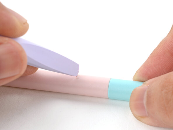

  1. Framework Laptop 12 Stylus Battery Replacement, Unlatch the battery: crwdns2935265:01crwdnd2935265:01crwdnd2935265:03crwdne2935265:0 Framework Laptop 12 Stylus Battery Replacement, Unlatch the battery: crwdns2935265:01crwdnd2935265:02crwdnd2935265:03crwdne2935265:0 Framework Laptop 12 Stylus Battery Replacement, Unlatch the battery: crwdns2935265:01crwdnd2935265:03crwdnd2935265:03crwdne2935265:0
    • Use the corner of your Framework Screwdriver or a small pin to depress the small rectangular battery clip on the barrel of the Stylus, near the cap.
  2. Framework Laptop 12 Stylus Battery Replacement, Remove the battery: crwdns2935265:02crwdnd2935265:01crwdnd2935265:03crwdne2935265:0 Framework Laptop 12 Stylus Battery Replacement, Remove the battery: crwdns2935265:02crwdnd2935265:02crwdnd2935265:03crwdne2935265:0 Framework Laptop 12 Stylus Battery Replacement, Remove the battery: crwdns2935265:02crwdnd2935265:03crwdnd2935265:03crwdne2935265:0
    • As you depress the clip, use your fingers to pull the battery straight out of the back of the Stylus to remove it.
  3. Framework Laptop 12 Stylus Battery Replacement, Install the replacement battery: crwdns2935265:03crwdnd2935265:01crwdnd2935265:03crwdne2935265:0 Framework Laptop 12 Stylus Battery Replacement, Install the replacement battery: crwdns2935265:03crwdnd2935265:02crwdnd2935265:03crwdne2935265:0 Framework Laptop 12 Stylus Battery Replacement, Install the replacement battery: crwdns2935265:03crwdnd2935265:03crwdnd2935265:03crwdne2935265:0
    • To install the replacement battery:
    • Align the battery clip with its barrel cutout.
    • Slide the battery into the Stylus until you hear a click. You should feel very little resistance.
    • Make sure the battery's fully seated. The clip should sit flush with the barrel.
  4. Framework Laptop 12 Stylus Battery Replacement: crwdns2935265:04crwdnd2935265:01crwdnd2935265:02crwdne2935265:0 Framework Laptop 12 Stylus Battery Replacement: crwdns2935265:04crwdnd2935265:02crwdnd2935265:02crwdne2935265:0
    • Plug the Stylus into your Framework Laptop 12 or a USB power source to bring the battery out of ship mode.
    • Once the LED lights up, unplug the Stylus. It's now ready for use!
