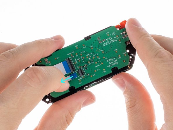

  5. Flipper Zero iButton board Replacement, Disconnect the battery: crwdns2935265:06crwdnd2935265:01crwdnd2935265:01crwdne2935265:0
    Spudger
    $3.99
    • Disconnect the battery by carefully prying the connector with a Spudger and pulling it out.
  6. Flipper Zero iButton board Replacement, Disconnect the ribbon cable: crwdns2935265:07crwdnd2935265:01crwdnd2935265:02crwdne2935265:0 Flipper Zero iButton board Replacement, Disconnect the ribbon cable: crwdns2935265:07crwdnd2935265:02crwdnd2935265:02crwdne2935265:0
    iFixit Opening Picks (Set of 6)
    • Disconnect the small ribbon cable from the board. Use a plastic pick to lift the latch up to open the lock and carefully pull it out of the connector.

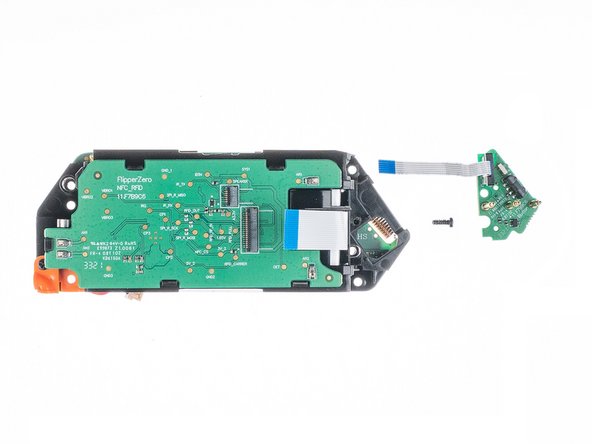

  7. Flipper Zero iButton board Replacement, Remove the iButton board: crwdns2935265:08crwdnd2935265:01crwdnd2935265:02crwdne2935265:0 Flipper Zero iButton board Replacement, Remove the iButton board: crwdns2935265:08crwdnd2935265:02crwdnd2935265:02crwdne2935265:0
    Phillips #0 Screwdriver
    $5.49
    • Unscrew the short screw holding the iButton board in place using a PH0 screwdriver.
    • Once the screw is removed, carefully remove the iButton board.
  8. Flipper Zero iButton board Replacement, Remove the cable from the iButton board: crwdns2935265:09crwdnd2935265:01crwdnd2935265:02crwdne2935265:0 Flipper Zero iButton board Replacement, Remove the cable from the iButton board: crwdns2935265:09crwdnd2935265:02crwdnd2935265:02crwdne2935265:0
    Spudger
    $3.99
    • To disconnect the flat cable from the iButton board, use a Spudger to carefully release the lock by pulling the latch up.
    • Once the connector is unlocked, gently pull the cable out of the connector.
