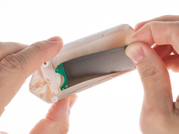

    • The board with the NFC antenna is glued to the bottom cover with adhesive tape.
    • To remove the board, gently pry one of the edges of the board with a plastic pick to peel off the adhesive tape.
    • Gently pull out the rest of the board by hand.
To reassemble your device, follow these instructions in reverse order and apply new adhesive where needed.
