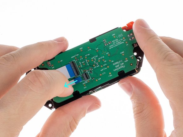

  6. Flipper Zero NFC RFID board Replacement, Disconnect the ribbon cables: crwdns2935265:07crwdnd2935265:01crwdnd2935265:02crwdne2935265:0 Flipper Zero NFC RFID board Replacement, Disconnect the ribbon cables: crwdns2935265:07crwdnd2935265:02crwdnd2935265:02crwdne2935265:0
    iFixit Opening Picks (Set of 6)
    • Disconnect the large ribbon cable from the board. Use a plastic pick to lift the latch up to release the locks.
    • Once the connectors are unlocked, carefully pull out the ribbon cables.

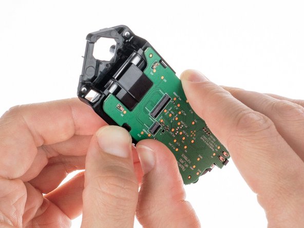

  7. Flipper Zero NFC RFID board Replacement, Remove the NFC RFID board: crwdns2935265:08crwdnd2935265:01crwdnd2935265:02crwdne2935265:0 Flipper Zero NFC RFID board Replacement, Remove the NFC RFID board: crwdns2935265:08crwdnd2935265:02crwdnd2935265:02crwdne2935265:0
    • To remove the NFC RFID board, release it from the latches in the sequence shown by pressing on the edge of the chassis near each latch.
    • Gently lift the NFC RFID board out of the chassis once all latches are released.
