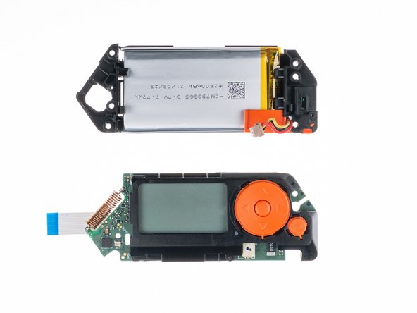

  5. Flipper Zero Display Replacement, Disconnect the battery: crwdns2935265:06crwdnd2935265:01crwdnd2935265:01crwdne2935265:0
    Spudger
    $3.99
    • Disconnect the battery by carefully prying the connector with a Spudger and pulling it out.

  7. Flipper Zero Display Replacement, Release the battery chassis: crwdns2935265:08crwdnd2935265:01crwdnd2935265:02crwdne2935265:0 Flipper Zero Display Replacement, Release the battery chassis: crwdns2935265:08crwdnd2935265:02crwdnd2935265:02crwdne2935265:0
    • To release the battery chassis, lightly rock it back and forth while pulling the two parts apart.
    • Be sure to apply gentle and consistent pressure to avoid damaging the device.

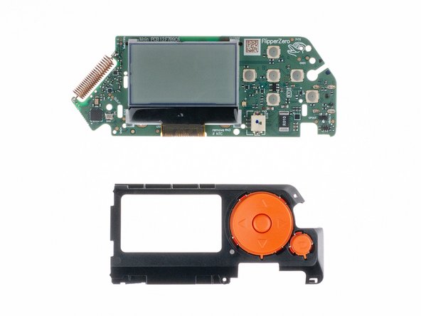

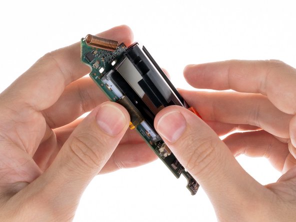

  9. Flipper Zero Display Replacement, Seperate the button chassis: crwdns2935265:010crwdnd2935265:01crwdnd2935265:03crwdne2935265:0 Flipper Zero Display Replacement, Seperate the button chassis: crwdns2935265:010crwdnd2935265:02crwdnd2935265:03crwdne2935265:0 Flipper Zero Display Replacement, Seperate the button chassis: crwdns2935265:010crwdnd2935265:03crwdnd2935265:03crwdne2935265:0
    • To seperate the button chassis and the board, press the latch on the side shown below and pull the chassis away from the board.

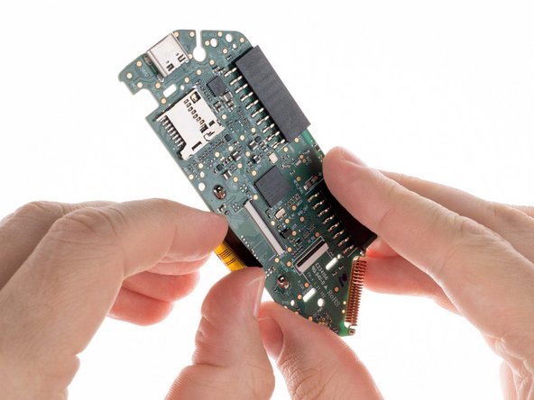

  10. Flipper Zero Display Replacement, Disconnect the screen: crwdns2935265:011crwdnd2935265:01crwdnd2935265:02crwdne2935265:0 Flipper Zero Display Replacement, Disconnect the screen: crwdns2935265:011crwdnd2935265:02crwdnd2935265:02crwdne2935265:0
    iFixit Opening Picks (Set of 6)
    $4.95
    • Disconnect the screen ribbon cable from the board. Use a plastic pick to lift the latch up to open the lock and carefully pull it out of the connector.
  11. Flipper Zero Display Replacement, Desolder the screen: crwdns2935265:012crwdnd2935265:01crwdnd2935265:01crwdne2935265:0
    • To remove the screen you need to desolder two contacts.
    • See this guide on how to solder and desolder connections.

Everything worked fine following this guide. Thank you for the help. In my case was just the glass that was broken, so at the end, i didnt needed to desolder. Just removed the glass with the Plastic pick and worked perfectly. Thank you again for the help.
