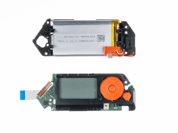

  7. Flipper Zero Battery Replacement, Release the battery chassis: crwdns2935265:08crwdnd2935265:01crwdnd2935265:02crwdne2935265:0 Flipper Zero Battery Replacement, Release the battery chassis: crwdns2935265:08crwdnd2935265:02crwdnd2935265:02crwdne2935265:0
    • To release the battery chassis, lightly rock it back and forth while pulling the two parts apart.
    • Be sure to apply gentle and consistent pressure to avoid damaging the device.

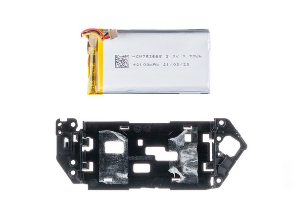

  9. Flipper Zero Battery Replacement, Remove the battery: crwdns2935265:010crwdnd2935265:01crwdnd2935265:03crwdne2935265:0 Flipper Zero Battery Replacement, Remove the battery: crwdns2935265:010crwdnd2935265:02crwdnd2935265:03crwdne2935265:0 Flipper Zero Battery Replacement, Remove the battery: crwdns2935265:010crwdnd2935265:03crwdnd2935265:03crwdne2935265:0
    iFixit Opening Picks (Set of 6)
    • The battery is attached to the chassis with double-sided tape. To remove it, use a plastic pick to gently peel the battery off the chassis.
    • Caution: Don't jab the battery with any sharp tools. A punctured battery may leak dangerous chemicals or catch fire.
To reassemble your device, follow these instructions in reverse order and apply new adhesive where needed.
