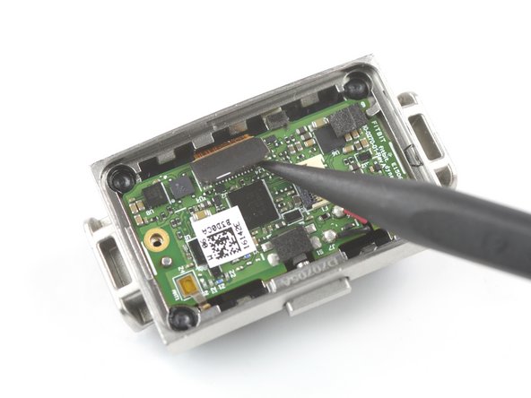

    • Use a pair of blunt nosed tweezers to remove the black sticker which covering the touch screen connector.
  12. Fitbit Charge 2 Battery Replacement, Open the ZIF connector: crwdns2935265:012crwdnd2935265:01crwdnd2935265:02crwdne2935265:0 Fitbit Charge 2 Battery Replacement, Open the ZIF connector: crwdns2935265:012crwdnd2935265:02crwdnd2935265:02crwdne2935265:0
    • Use the pointed end of a spudger to open the ZIF connector by pushing up the black flap.
  13. Fitbit Charge 2 Battery Replacement, Remove the touch screen assembly: crwdns2935265:013crwdnd2935265:01crwdnd2935265:03crwdne2935265:0 Fitbit Charge 2 Battery Replacement, Remove the touch screen assembly: crwdns2935265:013crwdnd2935265:02crwdnd2935265:03crwdne2935265:0 Fitbit Charge 2 Battery Replacement, Remove the touch screen assembly: crwdns2935265:013crwdnd2935265:03crwdnd2935265:03crwdne2935265:0
    • Pull the touch screen flex cable straight out its socket.
    • Remove the touch screen assembly.
