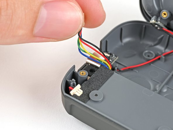

  12. Fairphone Fairbuds USB-C Port Replacement, Move the cable: crwdns2935265:012crwdnd2935265:01crwdnd2935265:02crwdne2935265:0 Fairphone Fairbuds USB-C Port Replacement, Move the cable: crwdns2935265:012crwdnd2935265:02crwdnd2935265:02crwdne2935265:0
    • Move the USB-C port cable out of its groove next to the screw peg.

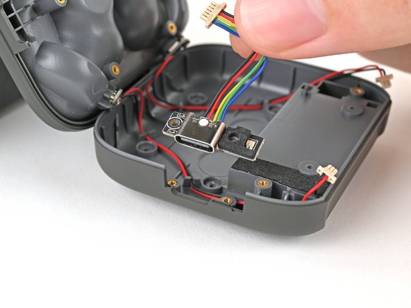

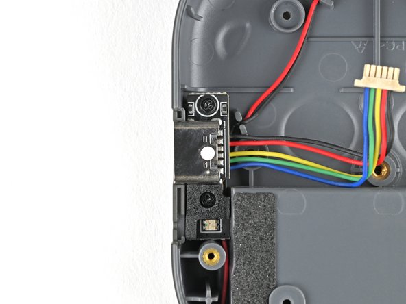

  13. Fairphone Fairbuds USB-C Port Replacement, Remove the USB-C port screws: crwdns2935265:013crwdnd2935265:01crwdnd2935265:02crwdne2935265:0 Fairphone Fairbuds USB-C Port Replacement, Remove the USB-C port screws: crwdns2935265:013crwdnd2935265:02crwdnd2935265:02crwdne2935265:0
    • Use a Phillips screwdriver to remove the two 3.9 mm‑long screws securing the USB-C port.
  14. Fairphone Fairbuds USB-C Port Replacement, Remove the USB-C port: crwdns2935265:014crwdnd2935265:01crwdnd2935265:02crwdne2935265:0 Fairphone Fairbuds USB-C Port Replacement, Remove the USB-C port: crwdns2935265:014crwdnd2935265:02crwdnd2935265:02crwdne2935265:0
    • Lift the USB-C port out of the charging core and remove it.
