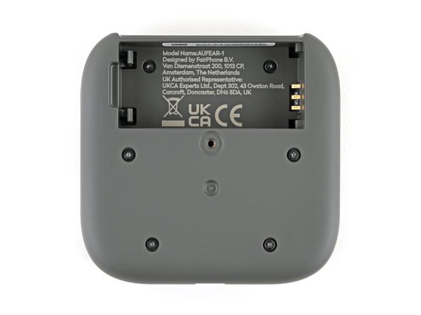

    • Flip your charging case upside down.
    • Use a Phillips screwdriver to remove the 4.5 mm‑long screw securing the outer shell.

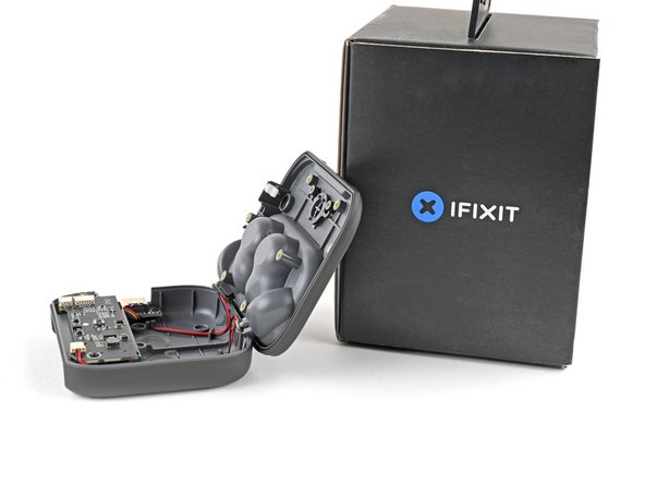

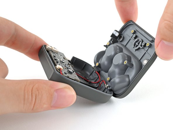

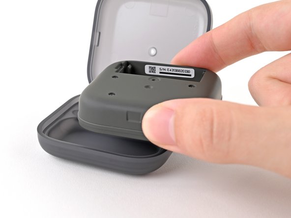

  7. Fairphone Fairbuds Mainboard Replacement, Open the charging core: crwdns2935265:07crwdnd2935265:01crwdnd2935265:03crwdne2935265:0 Fairphone Fairbuds Mainboard Replacement, Open the charging core: crwdns2935265:07crwdnd2935265:02crwdnd2935265:03crwdne2935265:0 Fairphone Fairbuds Mainboard Replacement, Open the charging core: crwdns2935265:07crwdnd2935265:03crwdnd2935265:03crwdne2935265:0
    • Flip over the charging core and grip its top half, near the pairing button.
    • Lift the top half and swing it over the core, letting it rest on something sturdy.
    • Don't try to separate the two halves, as they're still attached by cables.

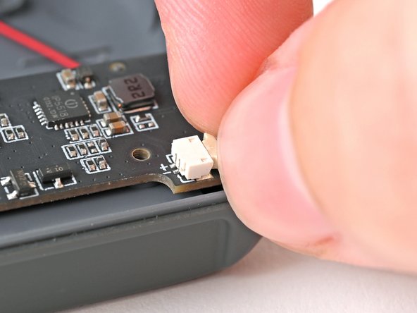

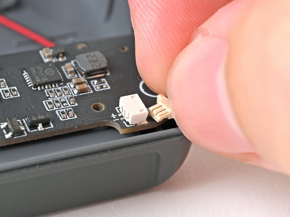

  8. Fairphone Fairbuds Mainboard Replacement, Disconnect the mainboard: crwdns2935265:08crwdnd2935265:01crwdnd2935265:03crwdne2935265:0 Fairphone Fairbuds Mainboard Replacement, Disconnect the mainboard: crwdns2935265:08crwdnd2935265:02crwdnd2935265:03crwdne2935265:0 Fairphone Fairbuds Mainboard Replacement, Disconnect the mainboard: crwdns2935265:08crwdnd2935265:03crwdnd2935265:03crwdne2935265:0
    • Use your fingers to pull the left earbud charging cable out of its socket.
    • Don't grip the cable! Only pull on the cable's plastic head.
    • If you're having trouble gripping the cable's head, use the tip of a spudger to push it out of its socket.

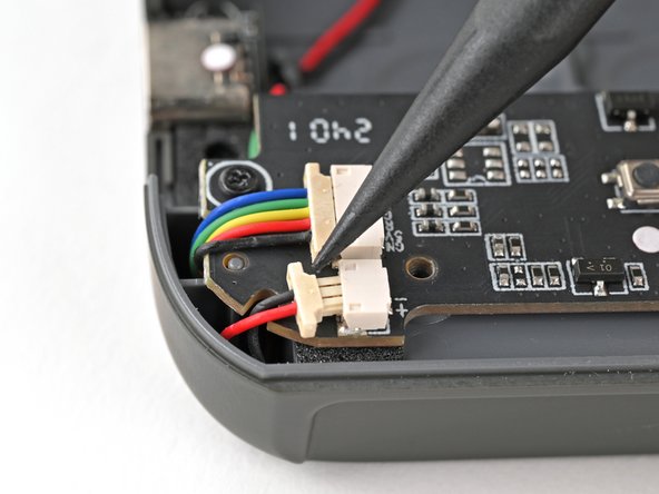

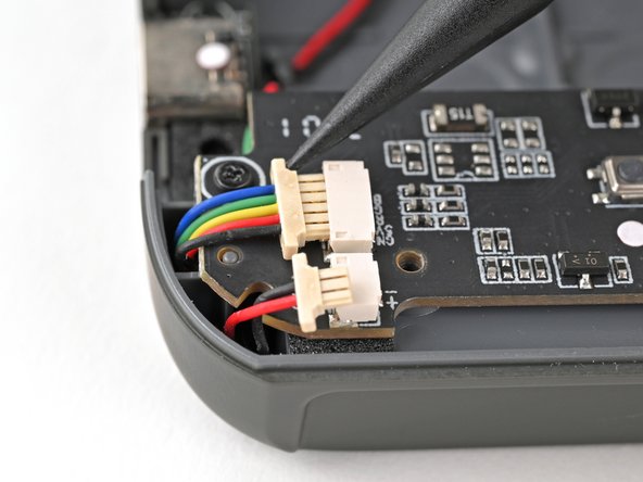

  9. Fairphone Fairbuds Mainboard Replacement: crwdns2935265:09crwdnd2935265:01crwdnd2935265:03crwdne2935265:0 Fairphone Fairbuds Mainboard Replacement: crwdns2935265:09crwdnd2935265:02crwdnd2935265:03crwdne2935265:0 Fairphone Fairbuds Mainboard Replacement: crwdns2935265:09crwdnd2935265:03crwdnd2935265:03crwdne2935265:0
    • Since the remaining connectors are next to each other, it can be difficult to grip them with your fingers. The following instructions use a spudger instead.
    • Use the tip of a spudger to push the right earbud cable head out of its socket to disconnect it.
    • Repeat for the USB-C port cable.

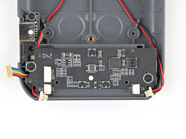

  10. Fairphone Fairbuds Mainboard Replacement, Remove the mainboard screws: crwdns2935265:010crwdnd2935265:01crwdnd2935265:02crwdne2935265:0 Fairphone Fairbuds Mainboard Replacement, Remove the mainboard screws: crwdns2935265:010crwdnd2935265:02crwdnd2935265:02crwdne2935265:0
    • Use a Phillips screwdriver to remove the two 3.9 mm‑long screws securing the mainboard.

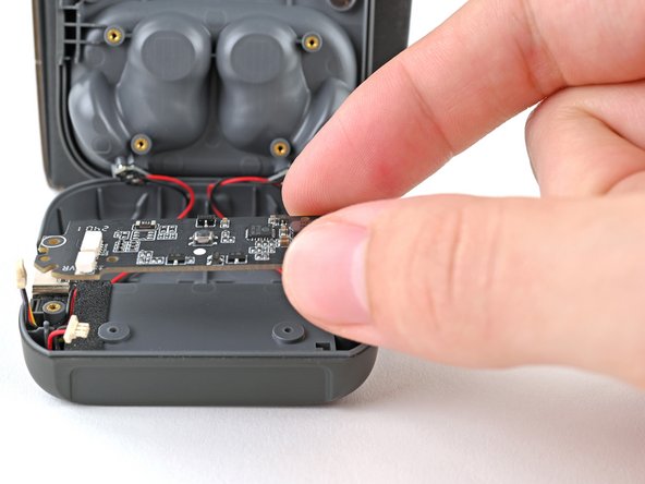

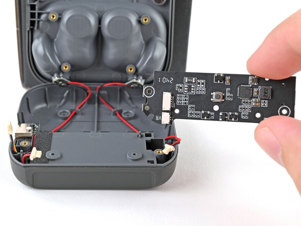

  11. Fairphone Fairbuds Mainboard Replacement, Remove the mainboard: crwdns2935265:011crwdnd2935265:01crwdnd2935265:03crwdne2935265:0 Fairphone Fairbuds Mainboard Replacement, Remove the mainboard: crwdns2935265:011crwdnd2935265:02crwdnd2935265:03crwdne2935265:0 Fairphone Fairbuds Mainboard Replacement, Remove the mainboard: crwdns2935265:011crwdnd2935265:03crwdnd2935265:03crwdne2935265:0
    • Lift the mainboard off its posts in the charging core and remove it.
