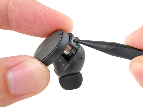

  2. Fairphone Fairbuds Earbud Battery Replacement, Remove the silicone ring: crwdns2935265:02crwdnd2935265:01crwdnd2935265:03crwdne2935265:0 Fairphone Fairbuds Earbud Battery Replacement, Remove the silicone ring: crwdns2935265:02crwdnd2935265:02crwdnd2935265:03crwdne2935265:0 Fairphone Fairbuds Earbud Battery Replacement, Remove the silicone ring: crwdns2935265:02crwdnd2935265:03crwdnd2935265:03crwdne2935265:0
    • Use your fingers or tweezers to pull the silicone ring off its groove in the earbud.
    • If you're reusing the silicone ring, don't stretch it too far or it won't fit snug in its groove.
    • Remove the silicone ring.
    • During reassembly, align the tab on the silicone ring with the notch on the earbud to ensure the ring fits snug.

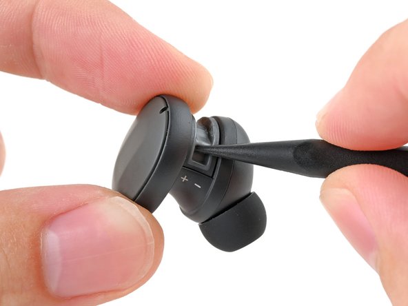

  3. Fairphone Fairbuds Earbud Battery Replacement, Remove the battery: crwdns2935265:03crwdnd2935265:01crwdnd2935265:03crwdne2935265:0 Fairphone Fairbuds Earbud Battery Replacement, Remove the battery: crwdns2935265:03crwdnd2935265:02crwdnd2935265:03crwdne2935265:0 Fairphone Fairbuds Earbud Battery Replacement, Remove the battery: crwdns2935265:03crwdnd2935265:03crwdnd2935265:03crwdne2935265:0
    • Insert the pointed end of a spudger into the notch on the battery tray, above the plus and minus sign.
    • Pry up to unlatch the battery tray from the earbud.

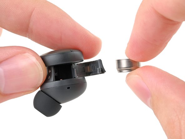

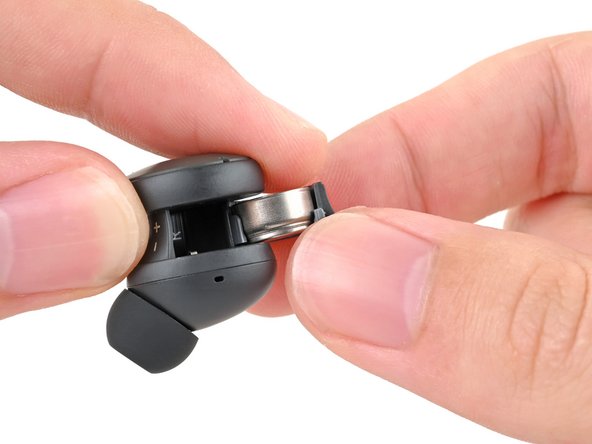

  4. Fairphone Fairbuds Earbud Battery Replacement: crwdns2935265:04crwdnd2935265:01crwdnd2935265:03crwdne2935265:0 Fairphone Fairbuds Earbud Battery Replacement: crwdns2935265:04crwdnd2935265:02crwdnd2935265:03crwdne2935265:0 Fairphone Fairbuds Earbud Battery Replacement: crwdns2935265:04crwdnd2935265:03crwdnd2935265:03crwdne2935265:0
    • Swing open the battery tray and remove the battery.
For optimal performance, calibrate your newly installed battery after completing this guide.
