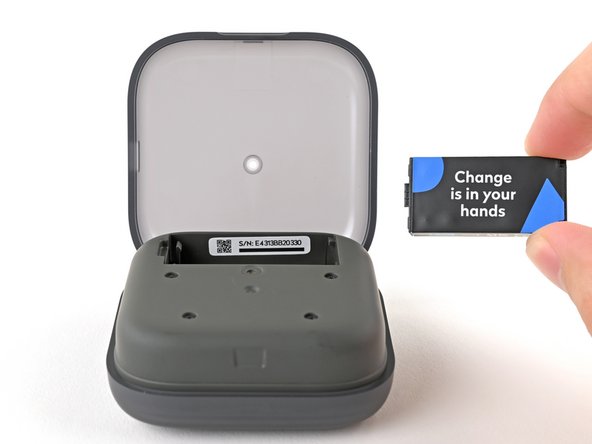

  2. Fairphone Fairbuds Charging Case Battery Replacement, Remove the battery: crwdns2935265:02crwdnd2935265:01crwdnd2935265:02crwdne2935265:0 Fairphone Fairbuds Charging Case Battery Replacement, Remove the battery: crwdns2935265:02crwdnd2935265:02crwdnd2935265:02crwdne2935265:0

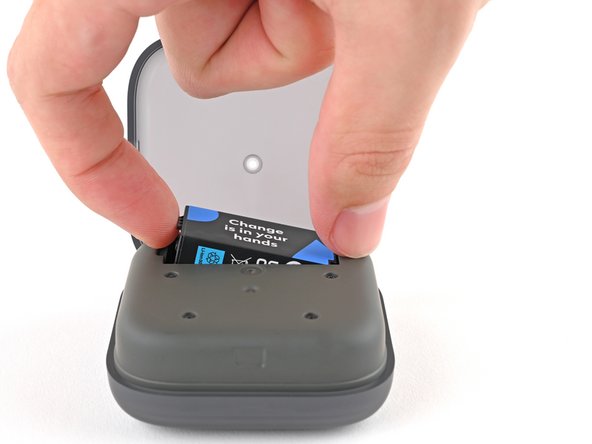

    • Flip up the bottom of the outer shell to expose the battery.
  3. Fairphone Fairbuds Charging Case Battery Replacement: crwdns2935265:03crwdnd2935265:01crwdnd2935265:03crwdne2935265:0 Fairphone Fairbuds Charging Case Battery Replacement: crwdns2935265:03crwdnd2935265:02crwdnd2935265:03crwdne2935265:0 Fairphone Fairbuds Charging Case Battery Replacement: crwdns2935265:03crwdnd2935265:03crwdnd2935265:03crwdne2935265:0
    • Use your finger to pry up the battery at its notch and remove it.
