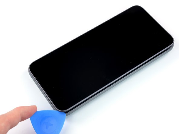

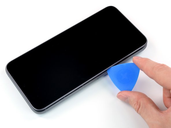

  7. Fairphone 4 Screen Replacement, Create a gap: crwdns2935265:07crwdnd2935265:01crwdnd2935265:03crwdne2935265:0 Fairphone 4 Screen Replacement, Create a gap: crwdns2935265:07crwdnd2935265:02crwdnd2935265:03crwdne2935265:0 Fairphone 4 Screen Replacement, Create a gap: crwdns2935265:07crwdnd2935265:03crwdnd2935265:03crwdne2935265:0
    • Flip the phone over so the screen faces up
    • Insert an opening pick between the screen and the frame.

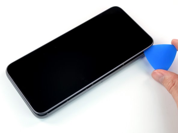

  8. Fairphone 4 Screen Replacement, Slide along the edge: crwdns2935265:08crwdnd2935265:01crwdnd2935265:02crwdne2935265:0 Fairphone 4 Screen Replacement, Slide along the edge: crwdns2935265:08crwdnd2935265:02crwdnd2935265:02crwdne2935265:0
    • Slide the opening pick along the edge to the top right corner.

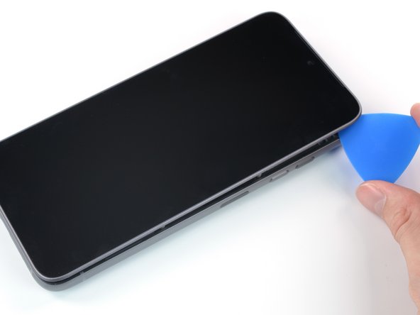

  9. Fairphone 4 Screen Replacement: crwdns2935265:09crwdnd2935265:01crwdnd2935265:02crwdne2935265:0 Fairphone 4 Screen Replacement: crwdns2935265:09crwdnd2935265:02crwdnd2935265:02crwdne2935265:0
    • Continue to slide the opening pick along the top of the phone.

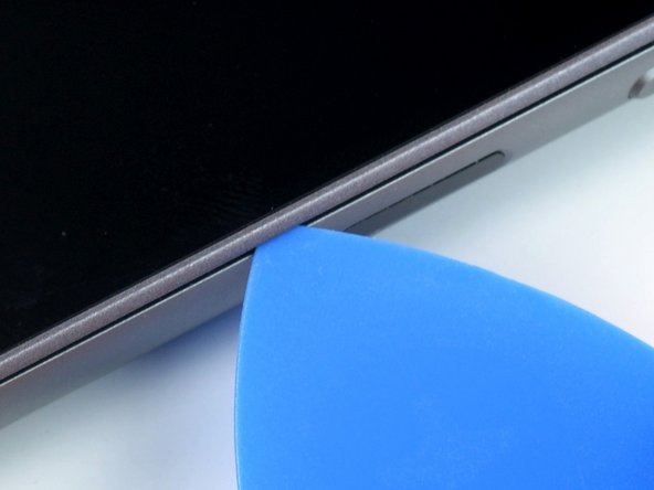

  10. Fairphone 4 Screen Replacement: crwdns2935265:010crwdnd2935265:01crwdnd2935265:03crwdne2935265:0 Fairphone 4 Screen Replacement: crwdns2935265:010crwdnd2935265:02crwdnd2935265:03crwdne2935265:0 Fairphone 4 Screen Replacement: crwdns2935265:010crwdnd2935265:03crwdnd2935265:03crwdne2935265:0
    • Slide the opening pick along the left side to the bottom left corner.

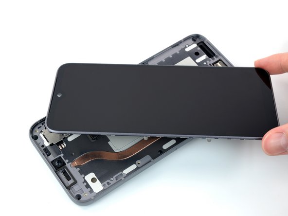

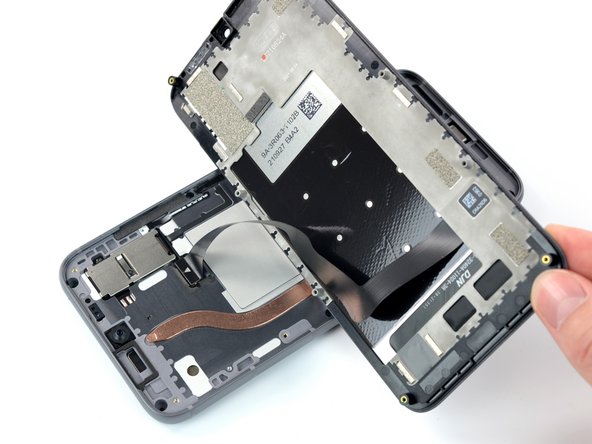

  11. Fairphone 4 Screen Replacement, Flip the screen over: crwdns2935265:011crwdnd2935265:01crwdnd2935265:03crwdne2935265:0 Fairphone 4 Screen Replacement, Flip the screen over: crwdns2935265:011crwdnd2935265:02crwdnd2935265:03crwdne2935265:0 Fairphone 4 Screen Replacement, Flip the screen over: crwdns2935265:011crwdnd2935265:03crwdnd2935265:03crwdne2935265:0
    • Do not remove the screen yet. It's still connected to the phone with a connection cable.
    • Grab the screen and lift it straight up just enough to clear its pegs from the frame.
    • Rotate the display carefully clock-wise and flip it over to get access to the connector.
    • Place the display on the device with the screen facing downwards.

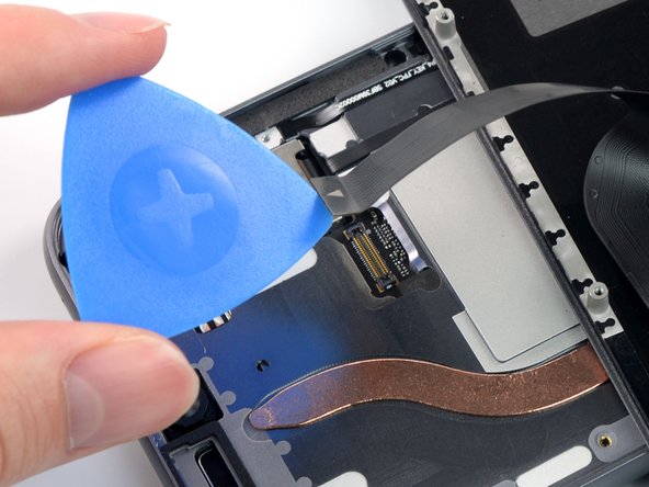

  12. Fairphone 4 Screen Replacement, Disconnect the cable: crwdns2935265:012crwdnd2935265:01crwdnd2935265:02crwdne2935265:0 Fairphone 4 Screen Replacement, Disconnect the cable: crwdns2935265:012crwdnd2935265:02crwdnd2935265:02crwdne2935265:0
    • Use an opening pick to pry up and disconnect the display connection cable.
    • Remove the screen.
    • Compare your new replacement screen to the original part—you may need to remove a front camera dust cover before you install it.
