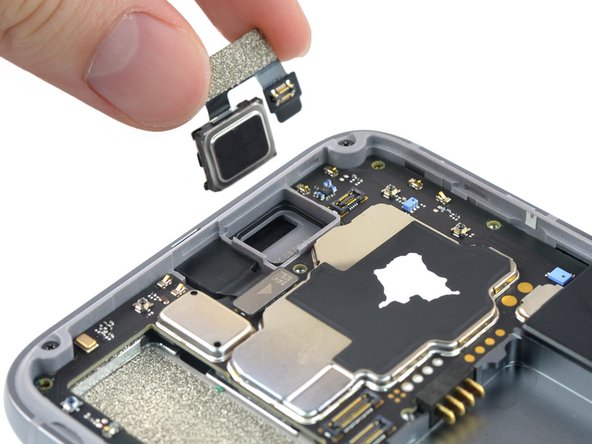

  12. Fairphone 4 Earpiece Speaker Replacement: crwdns2935265:012crwdnd2935265:01crwdnd2935265:01crwdne2935265:0
    • Lift the rear camera module and remove it.

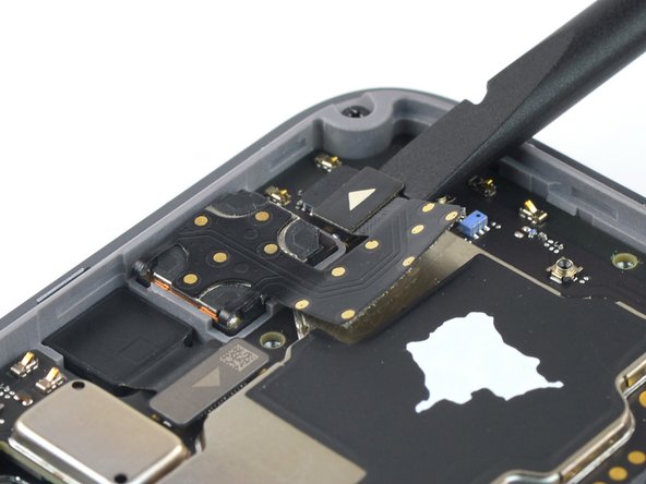

  13. Fairphone 4 Earpiece Speaker Replacement, Disconnect the earpiece speaker cable: crwdns2935265:013crwdnd2935265:01crwdnd2935265:02crwdne2935265:0 Fairphone 4 Earpiece Speaker Replacement, Disconnect the earpiece speaker cable: crwdns2935265:013crwdnd2935265:02crwdnd2935265:02crwdne2935265:0
    • Use a spudger to disconnect the earpiece speaker by prying the connector straight up from its socket.
  14. Fairphone 4 Earpiece Speaker Replacement, Remove the earpiece speaker: crwdns2935265:014crwdnd2935265:01crwdnd2935265:02crwdne2935265:0 Fairphone 4 Earpiece Speaker Replacement, Remove the earpiece speaker: crwdns2935265:014crwdnd2935265:02crwdnd2935265:02crwdne2935265:0
    • Use a spudger to lift the earpiece speaker so you can grab it.
    • Remove the earpiece speaker.
