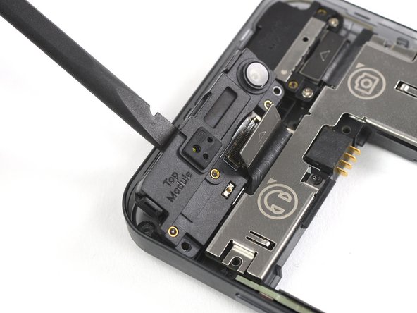

  10. Fairphone 3 Top Module Replacement, Top Module: crwdns2935265:010crwdnd2935265:01crwdnd2935265:01crwdne2935265:0
    • Remove the two 4.1mm-long Phillips #00 screws.
  11. Fairphone 3 Top Module Replacement: crwdns2935265:011crwdnd2935265:01crwdnd2935265:02crwdne2935265:0 Fairphone 3 Top Module Replacement: crwdns2935265:011crwdnd2935265:02crwdnd2935265:02crwdne2935265:0
    • Use a spudger to pry up and disconnect the top module connecting cable.
  12. Fairphone 3 Top Module Replacement: crwdns2935265:012crwdnd2935265:01crwdnd2935265:02crwdne2935265:0 Fairphone 3 Top Module Replacement: crwdns2935265:012crwdnd2935265:02crwdnd2935265:02crwdne2935265:0
    • Use a spudger to pry up the top module of your Fairphone 3.
  13. Fairphone 3 Top Module Replacement: crwdns2935265:013crwdnd2935265:01crwdnd2935265:02crwdne2935265:0 Fairphone 3 Top Module Replacement: crwdns2935265:013crwdnd2935265:02crwdnd2935265:02crwdne2935265:0
    • Use your fingers to remove the top module.
Information on what to do with the old module can be found on the FairPhone support page and in the FairPhone forum.
