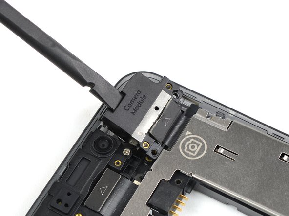

  10. Fairphone 3 Rear Camera Module Replacement, Rear Camera Module: crwdns2935265:010crwdnd2935265:01crwdnd2935265:01crwdne2935265:0
    • Remove the two 4.1mm-long Phillips #00 screws.
  11. Fairphone 3 Rear Camera Module Replacement: crwdns2935265:011crwdnd2935265:01crwdnd2935265:02crwdne2935265:0 Fairphone 3 Rear Camera Module Replacement: crwdns2935265:011crwdnd2935265:02crwdnd2935265:02crwdne2935265:0
    • Use a spudger to pry up and disconnect the camera connecting cable.
  12. Fairphone 3 Rear Camera Module Replacement: crwdns2935265:012crwdnd2935265:01crwdnd2935265:02crwdne2935265:0 Fairphone 3 Rear Camera Module Replacement: crwdns2935265:012crwdnd2935265:02crwdnd2935265:02crwdne2935265:0
    • Use a spudger to pry up the rear camera module.
  13. Fairphone 3 Rear Camera Module Replacement: crwdns2935265:013crwdnd2935265:01crwdnd2935265:01crwdne2935265:0
    • Remove the rear camera module.
Information on what to do with the old module can be found on the FairPhone support page and in the FairPhone forum.

I think this guide should mention that the camera connecting cable can become disconnected accidentally on its other end (under the metallic cover) which is easy to miss. This forum post helped me: https://forum.fairphone.com/t/be-careful...
The metallic cover can be removed easily after screwing off two Torx screws. Couple of people on the forum experienced this and it helped me solve my problem.
cmur2 - crwdns2934203:0crwdne2934203:0 crwdns2950251:0crwdne2950251:0
