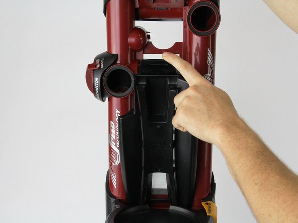

  1. Eureka SuctionSeal Pet Exhaust Filter Replacement, Exhaust Filter: crwdns2935265:01crwdnd2935265:01crwdnd2935265:01crwdne2935265:0
    • Pull up on the black handle on the top of the canister, and pull away from the body of the vacuum.

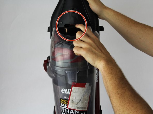

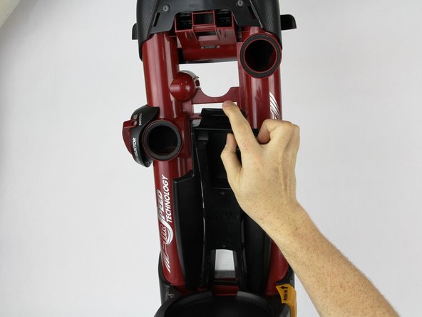

  2. Eureka SuctionSeal Pet Exhaust Filter Replacement: crwdns2935265:02crwdnd2935265:01crwdnd2935265:02crwdne2935265:0 Eureka SuctionSeal Pet Exhaust Filter Replacement: crwdns2935265:02crwdnd2935265:02crwdnd2935265:02crwdne2935265:0
    • Depress the black tab that says "pull" and pull outward.

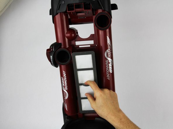

  3. Eureka SuctionSeal Pet Exhaust Filter Replacement: crwdns2935265:03crwdnd2935265:01crwdnd2935265:01crwdne2935265:0
    • Insert a finger into the grey plastic loop and pull.
    • The filter will pop out and leave an empty slot ready for replacement.
