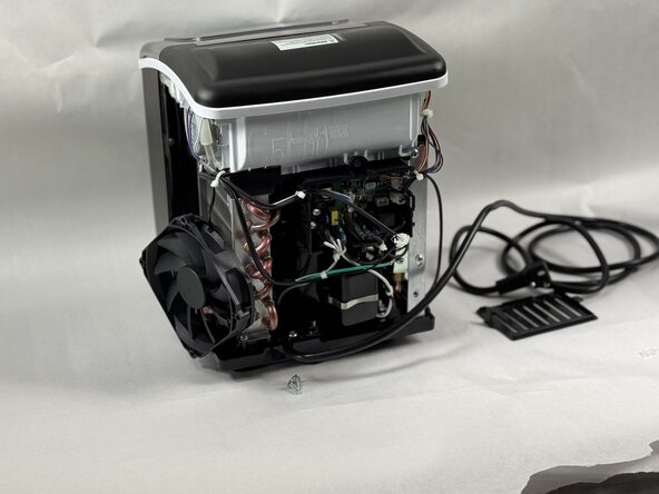

    • Rotate the device so that the screws on the bottom are visible.
    • Remove the two 15 mm Phillips screws.
    • Remove the two 10 mm Phillips screws.

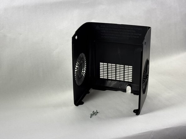

  2. Euhomy IM-06D Power Supply Cable Replacement: crwdns2935265:02crwdnd2935265:01crwdnd2935265:02crwdne2935265:0 Euhomy IM-06D Power Supply Cable Replacement: crwdns2935265:02crwdnd2935265:02crwdnd2935265:02crwdne2935265:0
    • Remove the back panel from the device.

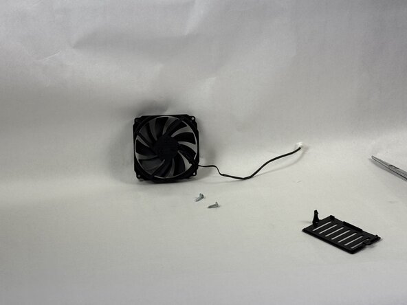

  3. Euhomy IM-06D Power Supply Cable Replacement: crwdns2935265:03crwdnd2935265:01crwdnd2935265:01crwdne2935265:0
    • Remove the two 10 mm Phillips screws that secure the fan.
  4. Euhomy IM-06D Power Supply Cable Replacement: crwdns2935265:04crwdnd2935265:01crwdnd2935265:02crwdne2935265:0 Euhomy IM-06D Power Supply Cable Replacement: crwdns2935265:04crwdnd2935265:02crwdnd2935265:02crwdne2935265:0
    • Remove the cover plate.
  5. Euhomy IM-06D Power Supply Cable Replacement: crwdns2935265:05crwdnd2935265:01crwdnd2935265:02crwdne2935265:0 Euhomy IM-06D Power Supply Cable Replacement: crwdns2935265:05crwdnd2935265:02crwdnd2935265:02crwdne2935265:0
    • Snip the zip tie holding the wires together.
    • Unplug the wire from the board.
    • Remove the fan from the device.

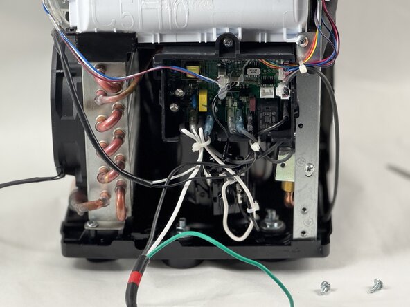

  6. Euhomy IM-06D Power Supply Cable Replacement, Power Supply Cable: crwdns2935265:06crwdnd2935265:01crwdnd2935265:01crwdne2935265:0
    • Follow the green ground wire and remove the 15 mm screw securing it with a Phillips screwdriver.
  7. Euhomy IM-06D Power Supply Cable Replacement: crwdns2935265:07crwdnd2935265:01crwdnd2935265:02crwdne2935265:0 Euhomy IM-06D Power Supply Cable Replacement: crwdns2935265:07crwdnd2935265:02crwdnd2935265:02crwdne2935265:0
    • Remove the Phillips screw holding the power cable in place.
  8. Euhomy IM-06D Power Supply Cable Replacement: crwdns2935265:08crwdnd2935265:01crwdnd2935265:02crwdne2935265:0 Euhomy IM-06D Power Supply Cable Replacement: crwdns2935265:08crwdnd2935265:02crwdnd2935265:02crwdne2935265:0
    • Follow the white wire and unplug it from the motherboard.

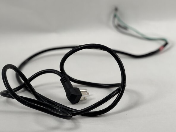

    • Follow the black wire and disconnect it from the motherboard.
    • Remove the power supply cable.
