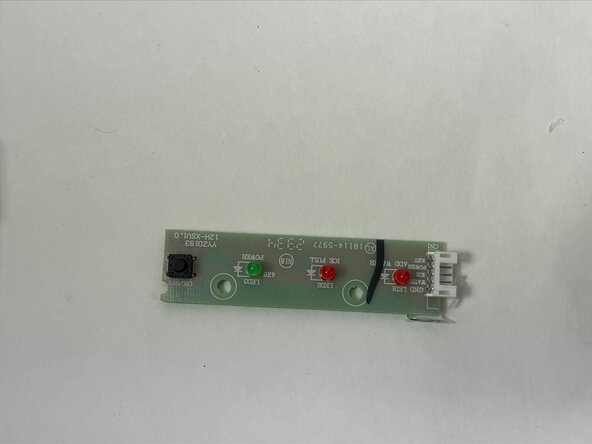

Euhomy IM-06D Digital Display Replacment
  1. Euhomy IM-06D Digital Display Replacment, Lid: crwdns2935265:01crwdnd2935265:01crwdnd2935265:03crwdne2935265:0 Euhomy IM-06D Digital Display Replacment, Lid: crwdns2935265:01crwdnd2935265:02crwdnd2935265:03crwdne2935265:0 Euhomy IM-06D Digital Display Replacment, Lid: crwdns2935265:01crwdnd2935265:03crwdnd2935265:03crwdne2935265:0
    • Open the lid.
    • Remove the two 5 mm Phillips screws that secure the lid.
    • Gently lift the lid off, with care not to damage or strain the attached cable.
  2. Euhomy IM-06D Digital Display Replacment: crwdns2935265:02crwdnd2935265:01crwdnd2935265:02crwdne2935265:0 Euhomy IM-06D Digital Display Replacment: crwdns2935265:02crwdnd2935265:02crwdnd2935265:02crwdne2935265:0
    • Use a jimmy to pop off the white cover on the back of the lid.
  3. Euhomy IM-06D Digital Display Replacment: crwdns2935265:03crwdnd2935265:01crwdnd2935265:03crwdne2935265:0 Euhomy IM-06D Digital Display Replacment: crwdns2935265:03crwdnd2935265:02crwdnd2935265:03crwdne2935265:0 Euhomy IM-06D Digital Display Replacment: crwdns2935265:03crwdnd2935265:03crwdnd2935265:03crwdne2935265:0
    • Remove the two 5 mm Phillips screws that secure the display PCB.
    • Remove the lid.
  4. Euhomy IM-06D Digital Display Replacment, Digital Display Replacment: crwdns2935265:04crwdnd2935265:01crwdnd2935265:02crwdne2935265:0 Euhomy IM-06D Digital Display Replacment, Digital Display Replacment: crwdns2935265:04crwdnd2935265:02crwdnd2935265:02crwdne2935265:0
    • Disconnect the display connector.
