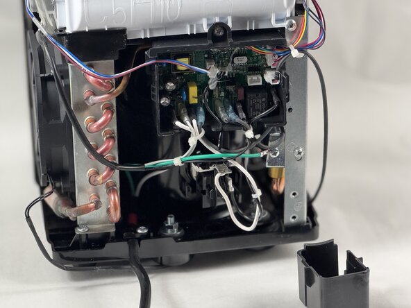

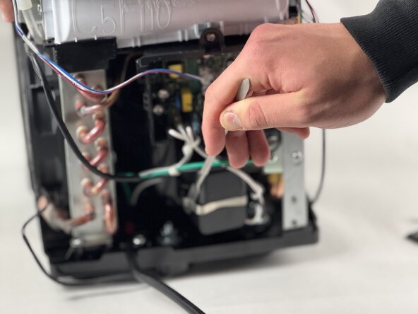

  6. Euhomy IM-06D Compressor Relay Replacement, Compressor Relay: crwdns2935265:06crwdnd2935265:01crwdnd2935265:03crwdne2935265:0 Euhomy IM-06D Compressor Relay Replacement, Compressor Relay: crwdns2935265:06crwdnd2935265:02crwdnd2935265:03crwdne2935265:0 Euhomy IM-06D Compressor Relay Replacement, Compressor Relay: crwdns2935265:06crwdnd2935265:03crwdnd2935265:03crwdne2935265:0
    • Locate the black box under the green ground cable and find the silver clip running across the back of it.
    • Use a pry tool remove the clip.
    • Remove the box.

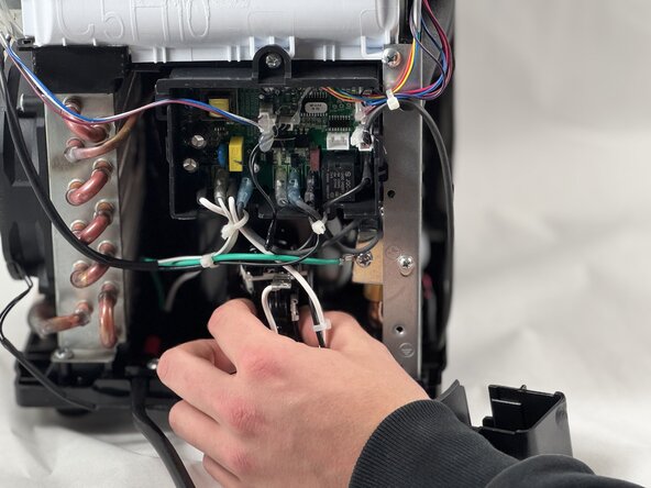

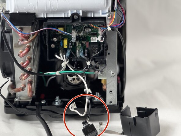

  7. Euhomy IM-06D Compressor Relay Replacement: crwdns2935265:07crwdnd2935265:01crwdnd2935265:03crwdne2935265:0 Euhomy IM-06D Compressor Relay Replacement: crwdns2935265:07crwdnd2935265:02crwdnd2935265:03crwdne2935265:0 Euhomy IM-06D Compressor Relay Replacement: crwdns2935265:07crwdnd2935265:03crwdnd2935265:03crwdne2935265:0
    • Locate the white wire and black relay.
    • Using your hands pull the wire and relay out of the compressor.
    • Once the relay and white wire have been removed you're ready to replace it with your new part.
