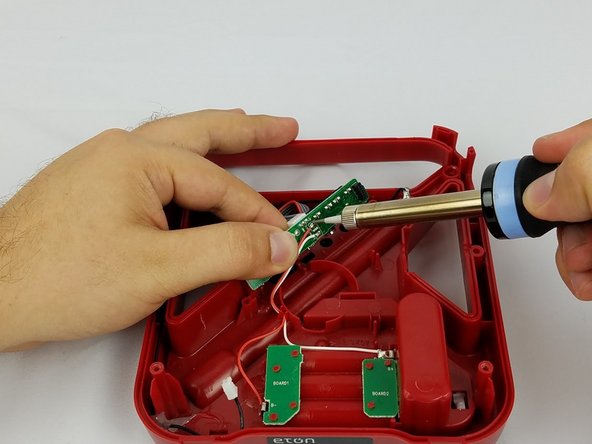

  8. Eton FRX3 I/O Board Replacement, I/O Board: crwdns2935265:08crwdnd2935265:01crwdnd2935265:02crwdne2935265:0 Eton FRX3 I/O Board Replacement, I/O Board: crwdns2935265:08crwdnd2935265:02crwdnd2935265:02crwdne2935265:0
    • Unsolder the red and white wires where the backup batteries connect to the I/O board.
