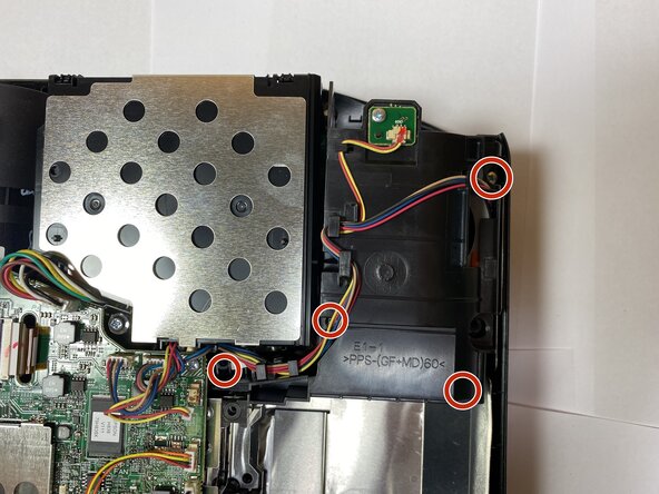

  4. Epson VS250 Fan Replacement: crwdns2935265:04crwdnd2935265:01crwdnd2935265:01crwdne2935265:0
    • Use a Phillips #1 screwdriver to remove the two 10 mm screws that are holding the side cover of the projector in place.

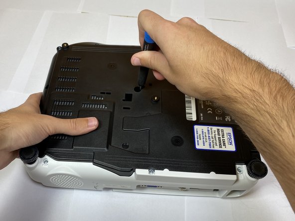

    • Flip the projector so that it lays upside down.
    • Using a Phillips #1 screwdriver, remove the eight 10 mm screws that secure the side portion of the projector.

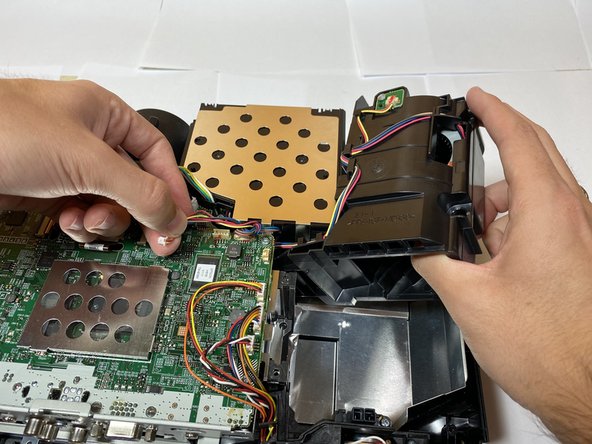

  8. Epson VS250 Fan Replacement: crwdns2935265:08crwdnd2935265:01crwdnd2935265:01crwdne2935265:0
    • Slowly lift up the top shell up and out of the device.
    • Disconnect the ribbon cable from the motherboard and remove the shell from the device.

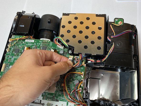

  9. Epson VS250 Fan Replacement, Fan: crwdns2935265:09crwdnd2935265:01crwdnd2935265:01crwdne2935265:0
    • Use a Phillips #1 screwdriver to remove the five 10 mm screws.
  10. Epson VS250 Fan Replacement: crwdns2935265:010crwdnd2935265:01crwdnd2935265:03crwdne2935265:0 Epson VS250 Fan Replacement: crwdns2935265:010crwdnd2935265:02crwdnd2935265:03crwdne2935265:0 Epson VS250 Fan Replacement: crwdns2935265:010crwdnd2935265:03crwdnd2935265:03crwdne2935265:0
    • Unplug the fan connector from the circuit board.
    • Remove the wires from the hooks that secure them to free the fan.

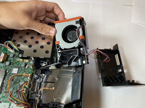

  11. Epson VS250 Fan Replacement: crwdns2935265:011crwdnd2935265:01crwdnd2935265:02crwdne2935265:0 Epson VS250 Fan Replacement: crwdns2935265:011crwdnd2935265:02crwdnd2935265:02crwdne2935265:0
    • Disconnect the wire and remove the black casing from the rest of the fan assembly.

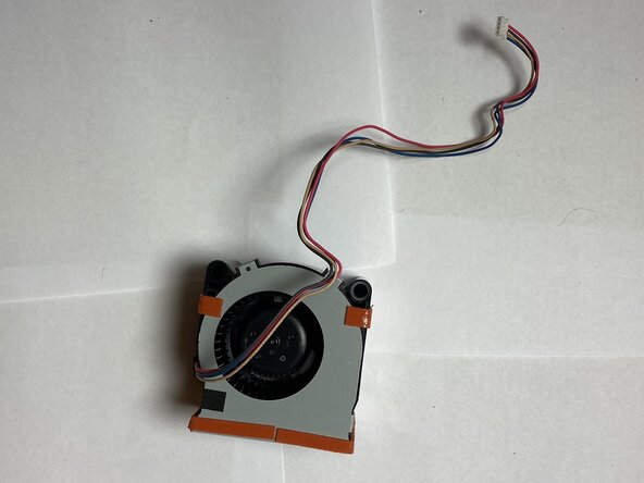

  12. Epson VS250 Fan Replacement: crwdns2935265:012crwdnd2935265:01crwdnd2935265:02crwdne2935265:0 Epson VS250 Fan Replacement: crwdns2935265:012crwdnd2935265:02crwdnd2935265:02crwdne2935265:0
    • Remove the fan from the device.
