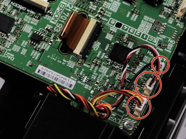

    1. Epson VS240 Lens Replacement, Motherboard: crwdns2935265:08crwdnd2935265:01crwdnd2935265:02crwdne2935265:0 Epson VS240 Lens Replacement, Motherboard: crwdns2935265:08crwdnd2935265:02crwdnd2935265:02crwdne2935265:0
      • Using a spudger or a plastic opening tool, disconnect all of the wires connected to the motherboard.

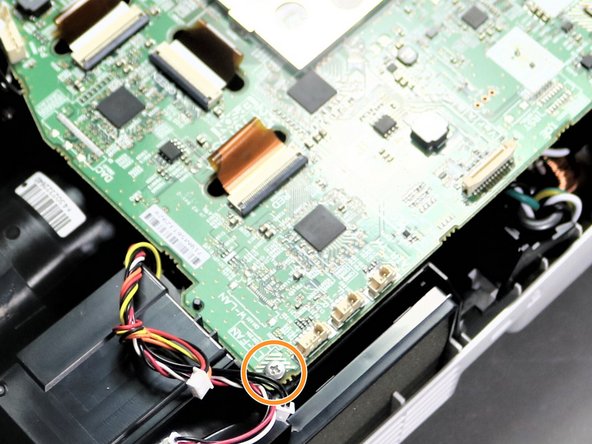

    2. Epson VS240 Lens Replacement: crwdns2935265:09crwdnd2935265:01crwdnd2935265:02crwdne2935265:0 Epson VS240 Lens Replacement: crwdns2935265:09crwdnd2935265:02crwdnd2935265:02crwdne2935265:0
      • Using the Phillips #1 screwdriver, remove three 6 mm screws.
      • Using the same Phillips #1 screwdriver, remove a single 10 mm screw in bottom right corner of motherboard.

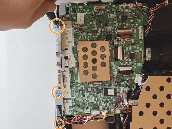

    3. Epson VS240 Lens Replacement: crwdns2935265:010crwdnd2935265:01crwdnd2935265:02crwdne2935265:0 Epson VS240 Lens Replacement: crwdns2935265:010crwdnd2935265:02crwdnd2935265:02crwdne2935265:0
      • Using a spudger or your fingernails, lift up the black locking tabs and disconnect the three ribbon cables from the motherboard.
      • For more information on Zero Insertion Force (ZIF) connectors, please visit this guide.
      • Using the Phillips #1 screwdriver, remove three 10 mm screws on the grey piece that is located on the side of the motherboard.

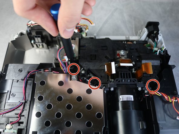

    1. Epson VS240 Lens Replacement, Lens: crwdns2935265:012crwdnd2935265:01crwdnd2935265:02crwdne2935265:0 Epson VS240 Lens Replacement, Lens: crwdns2935265:012crwdnd2935265:02crwdnd2935265:02crwdne2935265:0
      • Rotate the projector 180 degrees to match orientation in images.
      • Using the Phillips #2 screwdriver, remove four inner 11 mm screws under the black box connected to the lens.
      • These screws are located deep into the projector and you may need a screwdriver extender to reach two of the four screws.

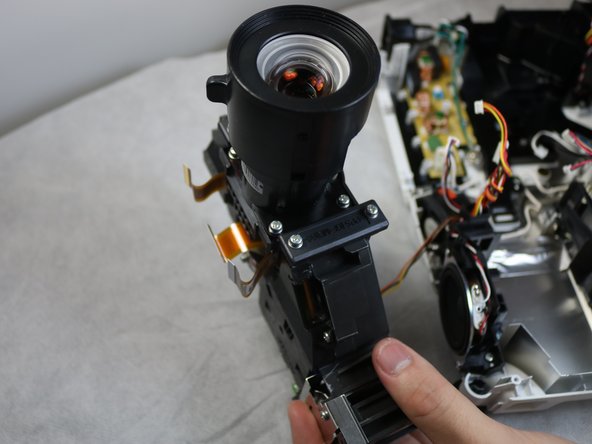

    2. Epson VS240 Lens Replacement: crwdns2935265:013crwdnd2935265:01crwdnd2935265:02crwdne2935265:0 Epson VS240 Lens Replacement: crwdns2935265:013crwdnd2935265:02crwdnd2935265:02crwdne2935265:0
      • Detach the wire above the lens using plastic pry bar.
      • These wires can also be removed by hand; however, a plastic opening tool may be used for more prying power.
      • Slowly lift the black assembly out of the device.
      • Be careful of the wire still connected. It does not need to be removed so lay the black assembly close to the projector so no tension is on the wire.
