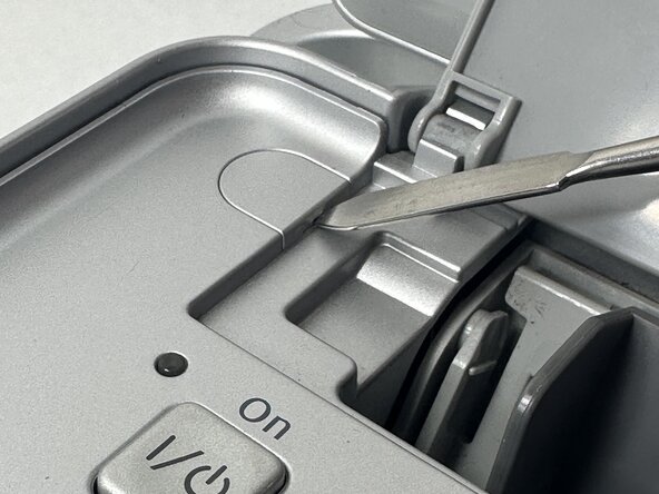

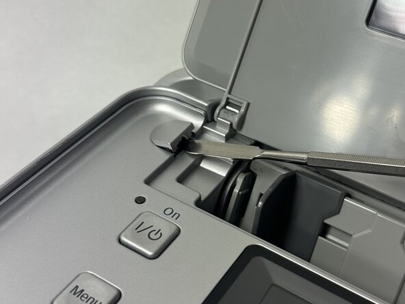

    • Power off device and use a metal spudger to remove each of the two caps over the screws that hold the top plate to the device.

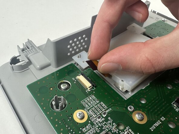

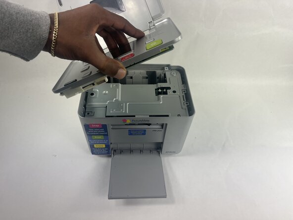

    • Gently lift the lid and turn it to face the daughterboard underneath.
    • Gently pull the no-fuss ribbon cable out from its connector.
    • The other end of the ribbon cable is still in the device's motherboard. Only remove the end connected to the daughterboard unless stated in a later step in order to not lose it due to unnecessary removal.

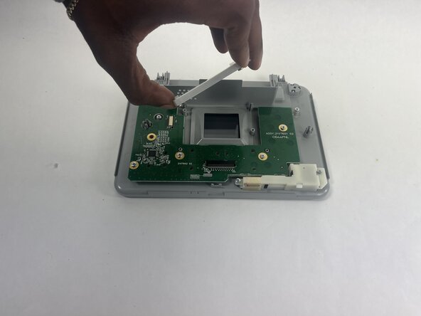

    • Remove the printer top plate.
  5. Epson PictureMate Pal PM 200 Display Replacement, Display: crwdns2935265:05crwdnd2935265:01crwdnd2935265:01crwdne2935265:0
    • Set the panel to the side on a neat, flat surface.

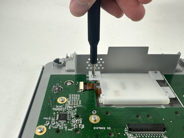

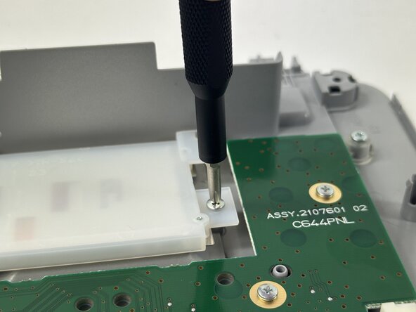

    • Remove the two 8 mm Phillips screws securing the display assembly to the top panel.

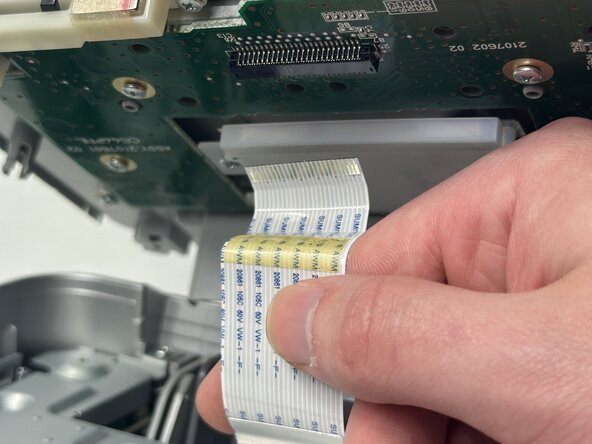

    • Pull the black ZIF locking flap toward the ribbon cable.
    • Disconnect the ribbon cable from the daughterboard.

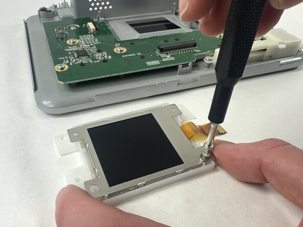

    • Remove the two 8 mm screws that secure the display to the housing.

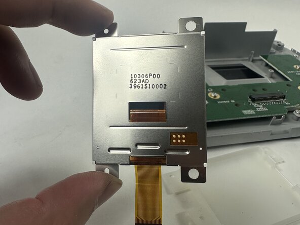

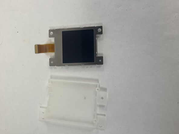

  10. Epson PictureMate Pal PM 200 Display Replacement: crwdns2935265:010crwdnd2935265:01crwdnd2935265:03crwdne2935265:0 Epson PictureMate Pal PM 200 Display Replacement: crwdns2935265:010crwdnd2935265:02crwdnd2935265:03crwdne2935265:0 Epson PictureMate Pal PM 200 Display Replacement: crwdns2935265:010crwdnd2935265:03crwdnd2935265:03crwdne2935265:0
    • Remove the display from the housing.
