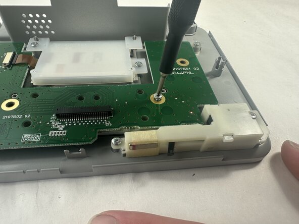

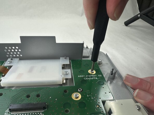

  6. Epson PictureMate Pal PM 200 Daughter Board: crwdns2935265:06crwdnd2935265:01crwdnd2935265:03crwdne2935265:0 Epson PictureMate Pal PM 200 Daughter Board: crwdns2935265:06crwdnd2935265:02crwdnd2935265:03crwdne2935265:0 Epson PictureMate Pal PM 200 Daughter Board: crwdns2935265:06crwdnd2935265:03crwdnd2935265:03crwdne2935265:0
    • Remove all five 8 mm Phillips screws that secure the daughterboard to the top panel.

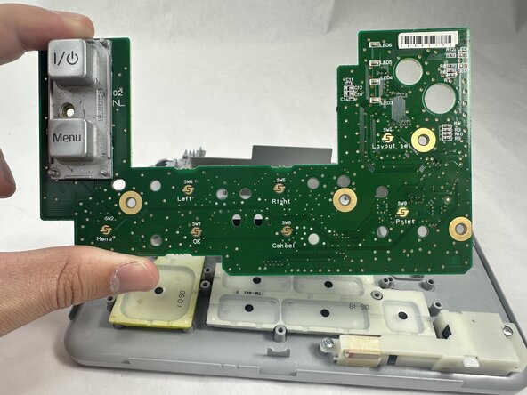

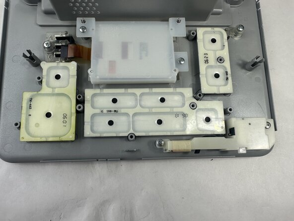

  7. Epson PictureMate Pal PM 200 Daughter Board: crwdns2935265:07crwdnd2935265:01crwdnd2935265:03crwdne2935265:0 Epson PictureMate Pal PM 200 Daughter Board: crwdns2935265:07crwdnd2935265:02crwdnd2935265:03crwdne2935265:0 Epson PictureMate Pal PM 200 Daughter Board: crwdns2935265:07crwdnd2935265:03crwdnd2935265:03crwdne2935265:0
    • Remove the daughterboard by lifting it away from the top plate.
